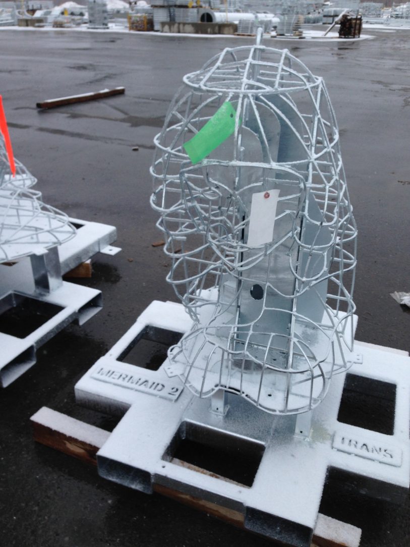

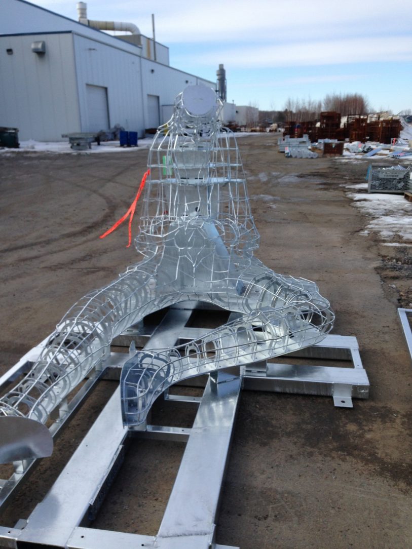

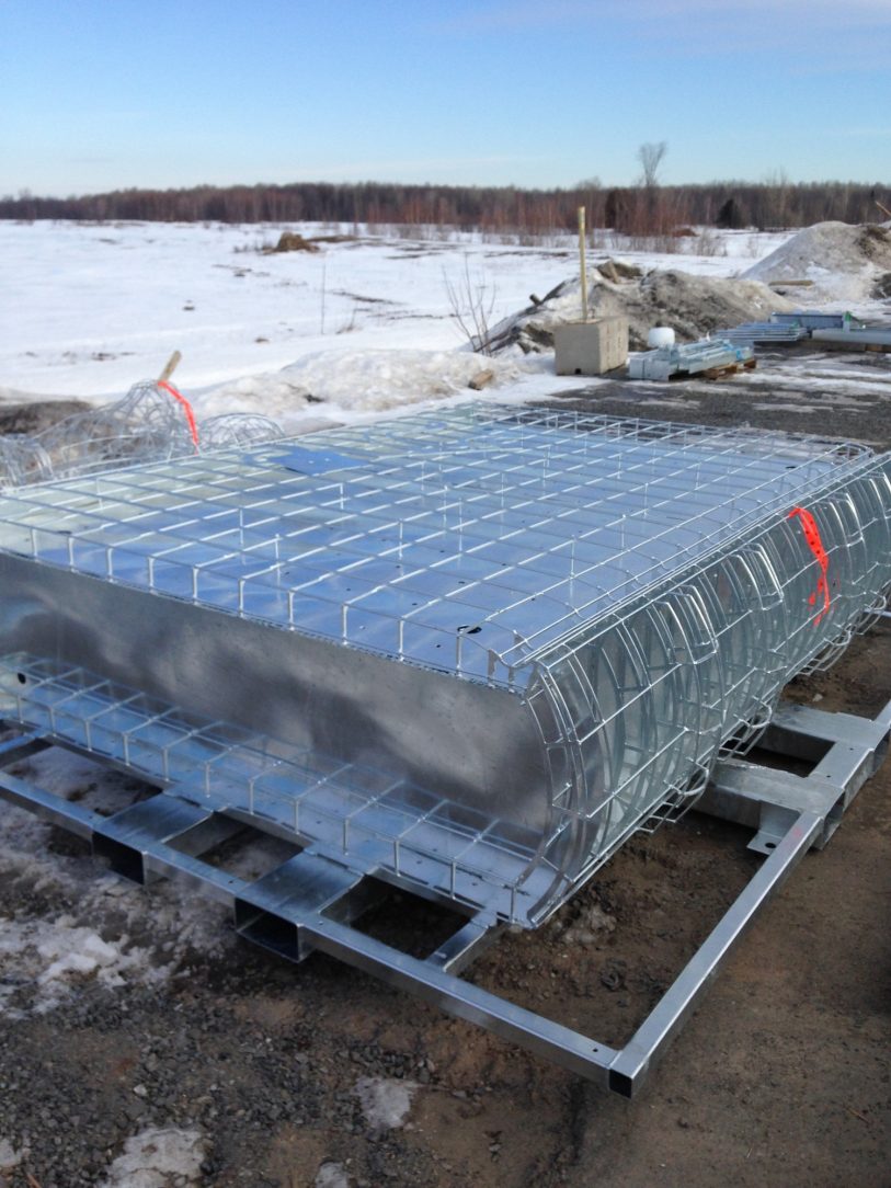

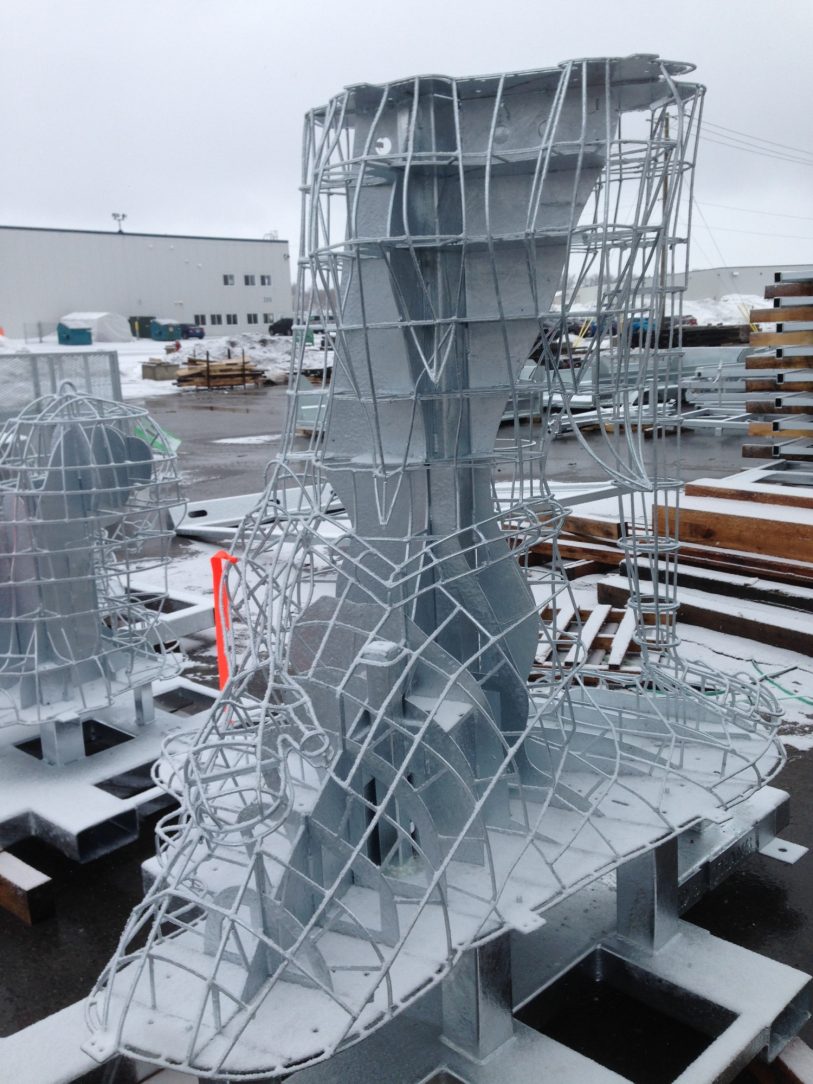

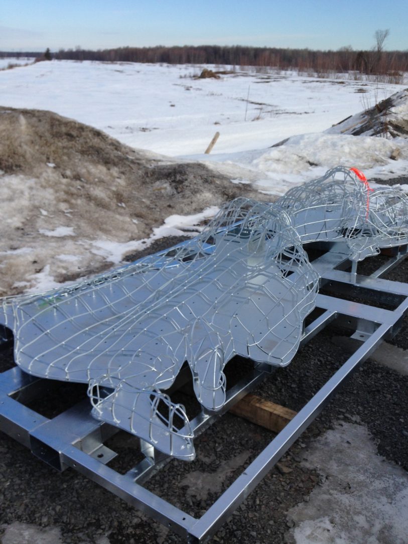

So for the 2018 version of the Exhibition Acme Décor’s artisans in Beloeil Canada went to work again fabricating additional exoskeletons for several new ecosculptures. This time with one vital difference, these were to be protected by Hot-Dip Galvanizing. Designed to be light for both cost and accessibility reasons the small diameter bar stock of these exoskeletons are by design susceptible to failure by corrosion. The complex three dimensional shapes renders complete painting coverage nearly impossible. Furthermore constant planting, pruning and weeding work not to mention transport and assembly constantly causes further paint failures and degradation. By comparison the rugged strength of Hot-Dip and its full immersion principle meets these challenges effortlessly.
The low cost and quick turnaround as well as the large dimension local zinc baths made Hot-Dip the easy choice as well as the right choice. As such with the incredible corrosion resisting power of pure natural zinc these new ecosculptures should easily live on for decades and decades!

The entire ecostructures are Hot-Dip Galvanized in component form for transport.
