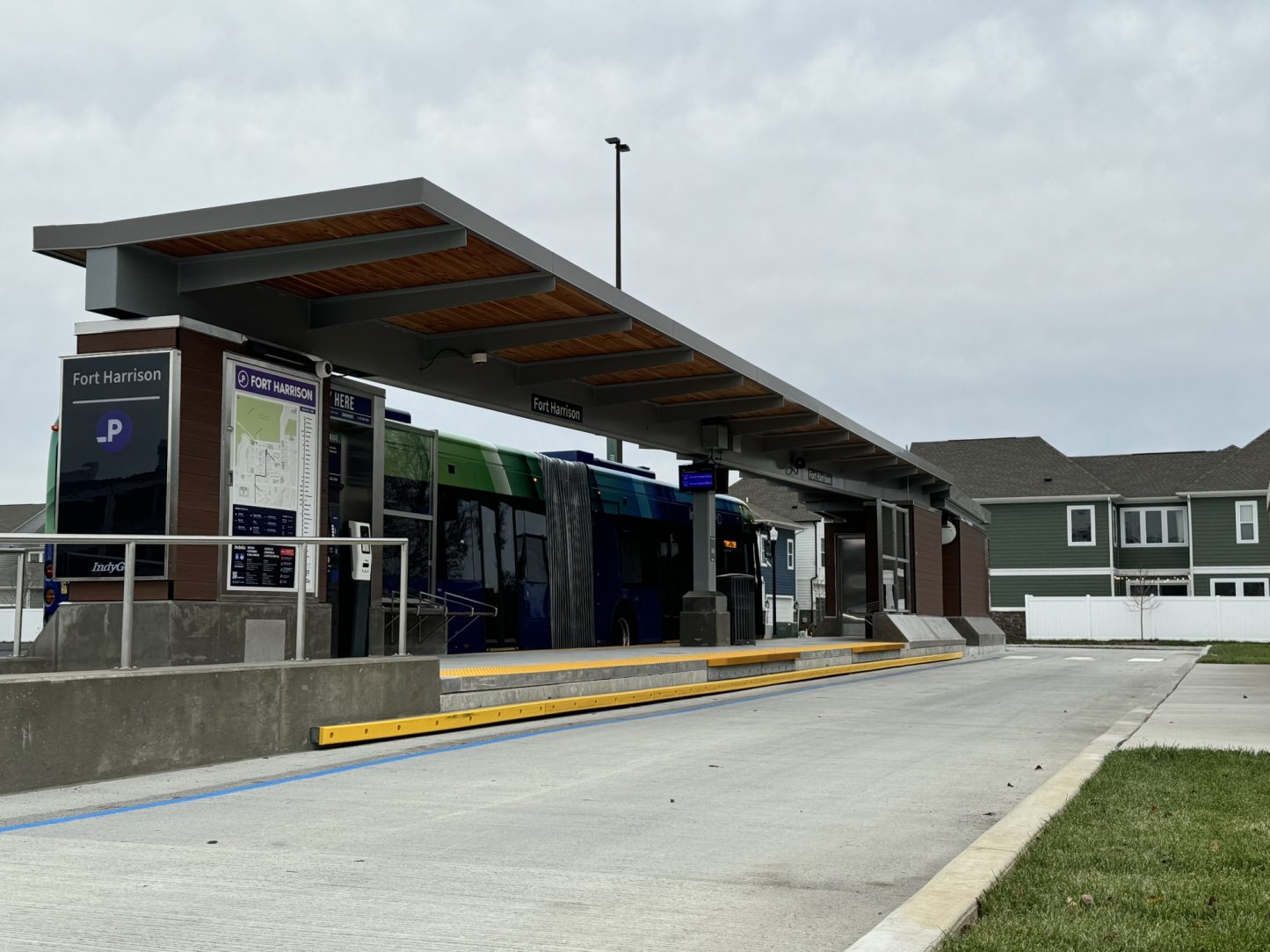

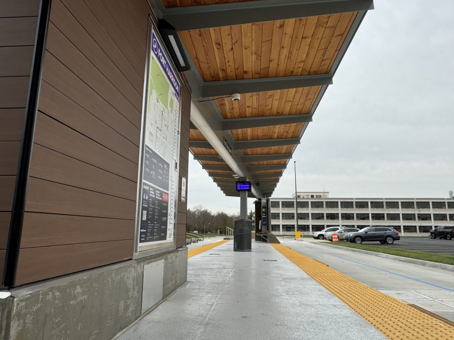

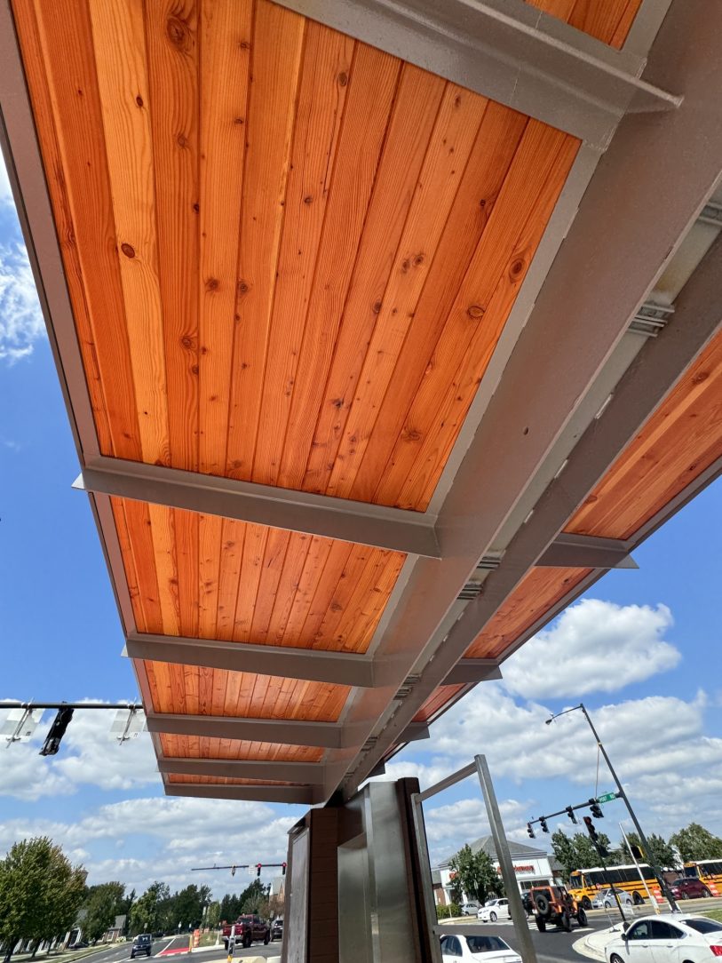

The new canopy stations are a standout feature of the Purple Line, offering both functional and aesthetic upgrades to the transit experience. Designed to provide shelter from the elements and improve passenger comfort, these stations also make a bold statement in terms of modern design and materials.

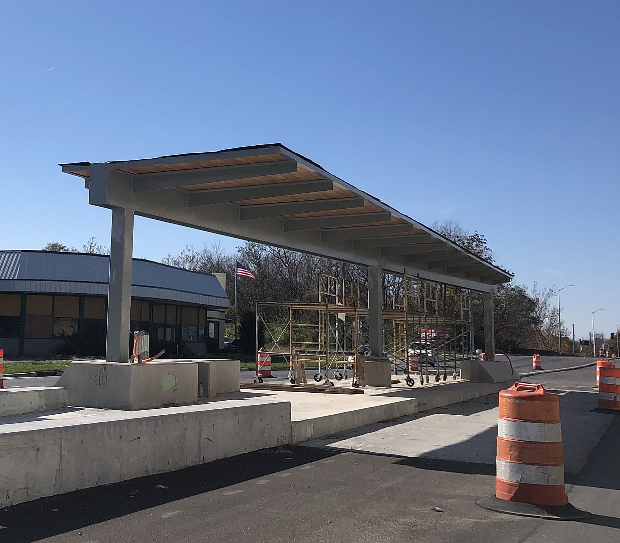

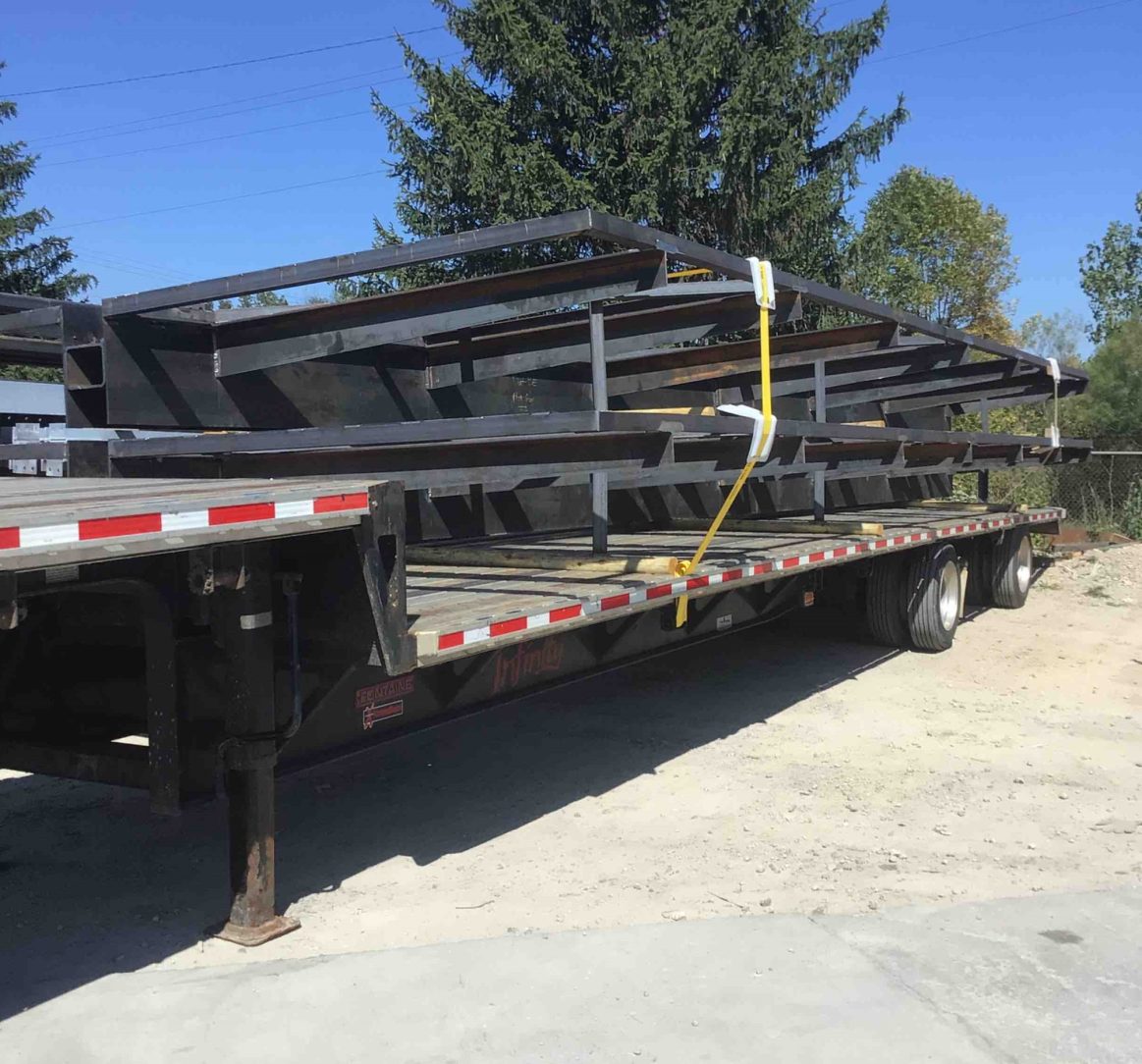

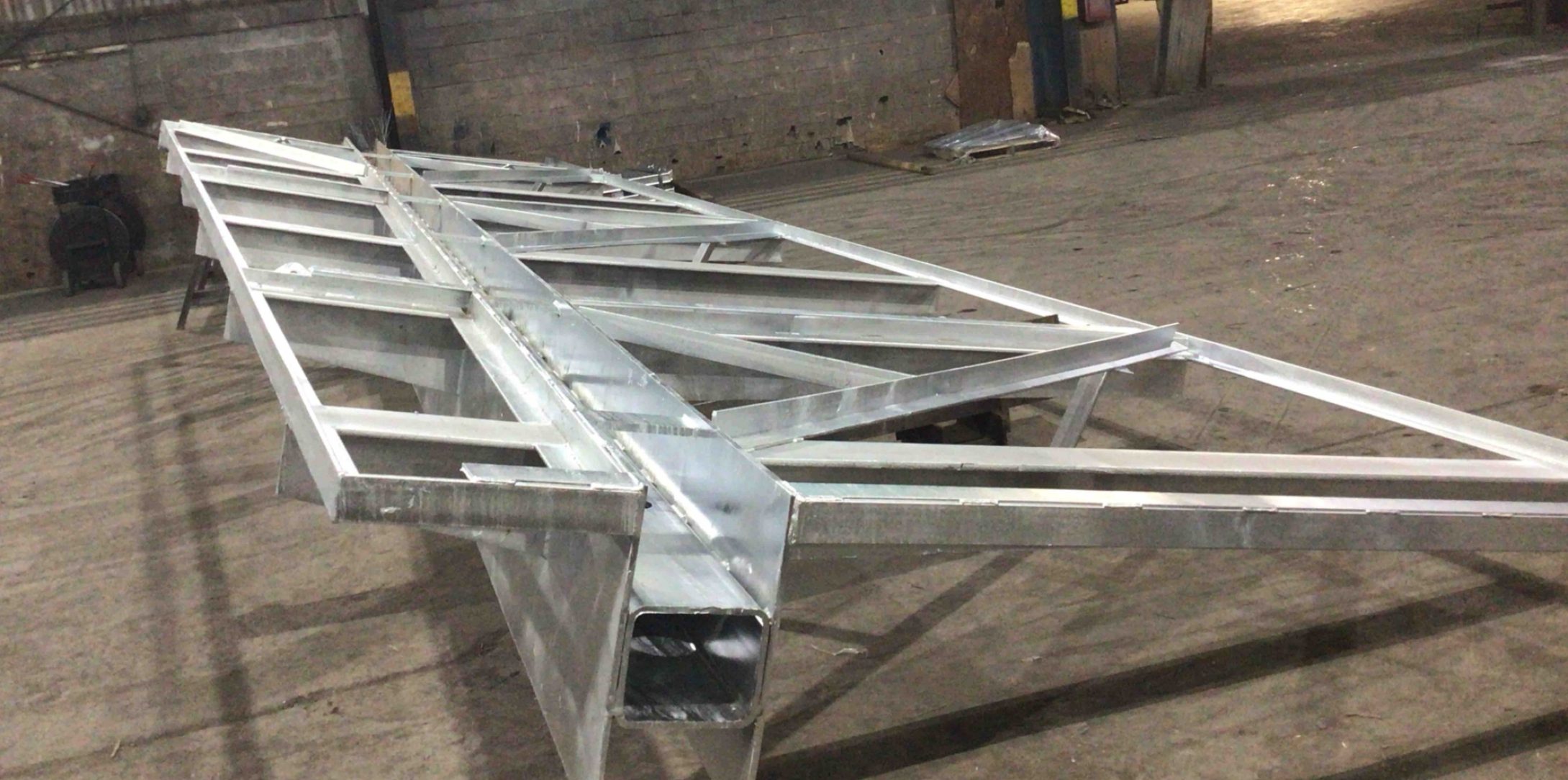

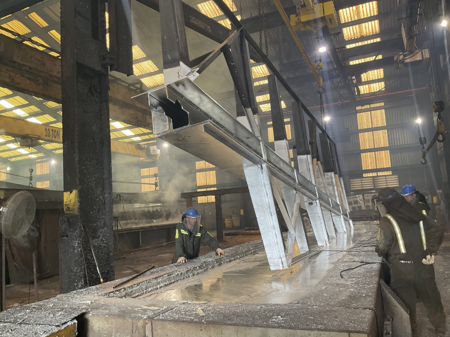

The canopy stations were constructed using a robust structural framework made from 345,000 pounds of galvanized steel, ensuring that the stations are not only sturdy but also resistant to the harsh weather conditions that can affect outdoor infrastructure. Hot-dip galvanizing is a process that involves coating steel with a layer of zinc, which helps to protect the metal from corrosion, rust, and other environmental factors. This corrosion-resistant property is especially important in areas like Indianapolis, where varying temperatures and seasonal weather changes can cause wear and tear on exposed materials.
Hot-dip galvanizing was selected not only for its durability but also for its cost-effectiveness. This process provides long-lasting protection against corrosion, greatly reducing the need for ongoing maintenance and costly repairs. By minimizing upkeep requirements, hot-dip galvanizing offers a lower total cost of ownership over the life of the infrastructure. For IndyGo, this translates into a budget-friendly solution that allows resources to be allocated more efficiently, ensuring that public funds are maximized to support other transit improvements and services.
To further enhance the longevity and appearance of the stations, the galvanized steel was treated with a duplex coating process—an advanced finishing technique that involves both galvanizing and painting. The duplex coating provides an additional layer of protection, offering both resistance to corrosion and an attractive, uniform finish. The result is a durable and visually appealing structure that will stand the test of time, requiring minimal maintenance over the years.

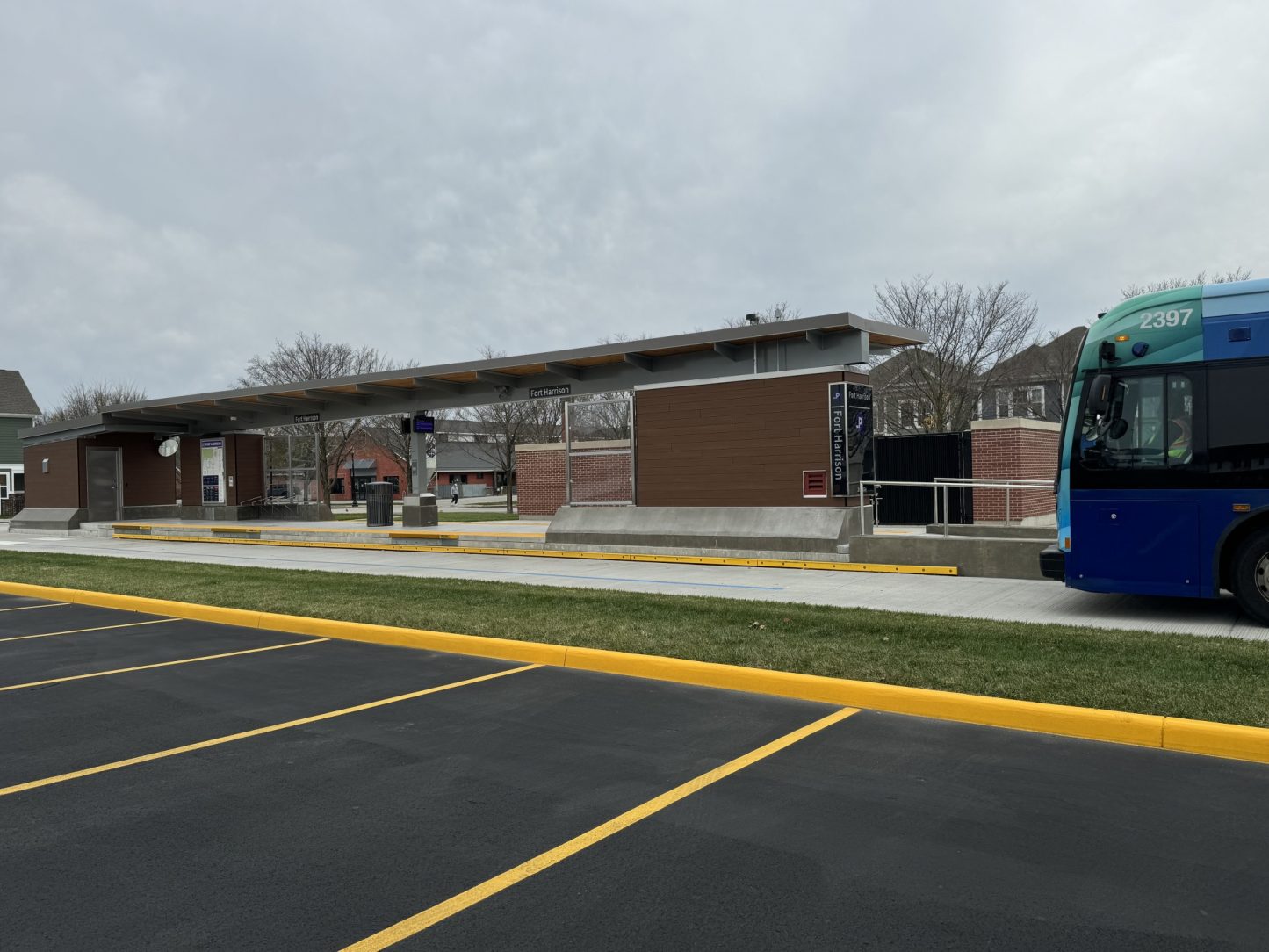

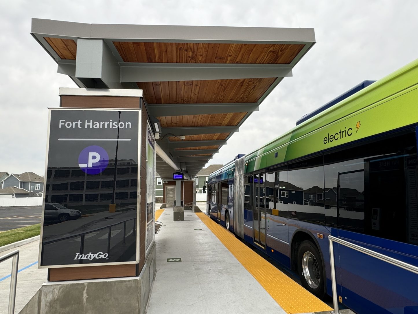

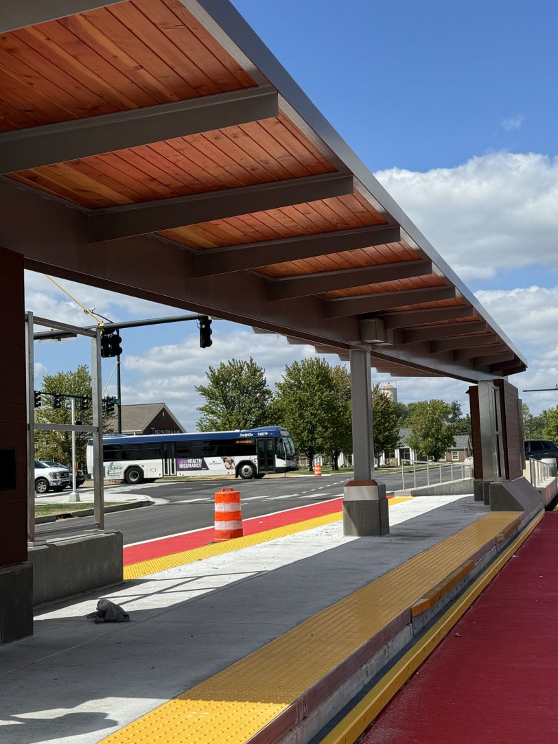

A total of 18 canopy stations have been constructed along the 15.2-mile stretch of the Purple Line, providing riders with convenient access points to the BRT service. Each station is equipped with shelters, seating, lighting, and electronic displays that offer real-time updates on bus arrivals and departures. The design of the canopies is sleek and modern, blending functionality with a contemporary aesthetic that complements the urban landscape of Indianapolis and Lawrence.
The use of galvanized steel and duplex coatings was particularly important in maintaining the structural integrity and visual appeal of these stations over time. The materials not only contribute to the long-term durability of the stations but also ensure they can withstand the demands of high traffic volumes and the wear and tear associated with public transportation hubs.
