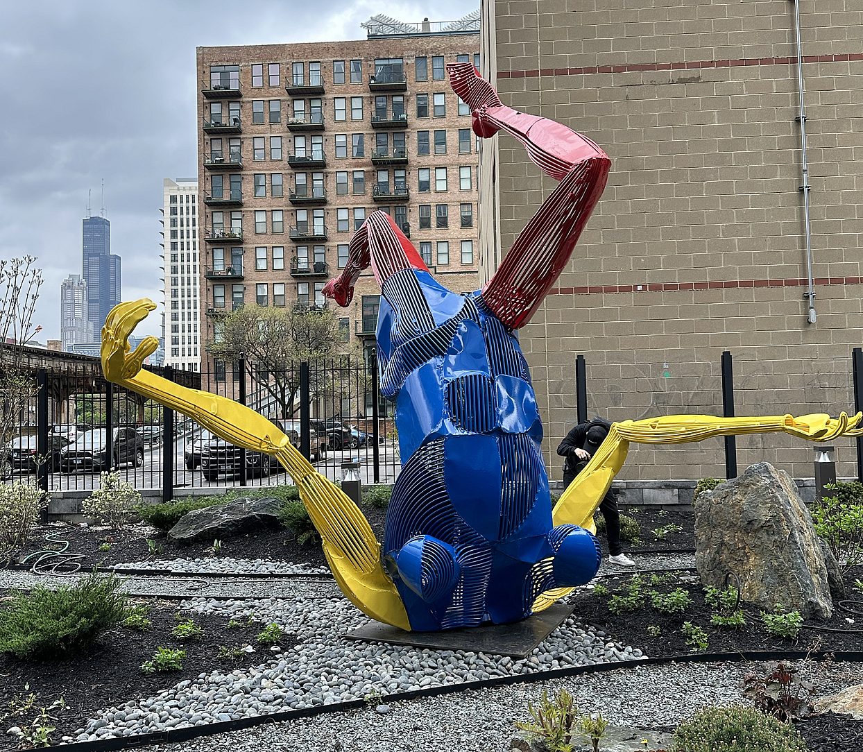

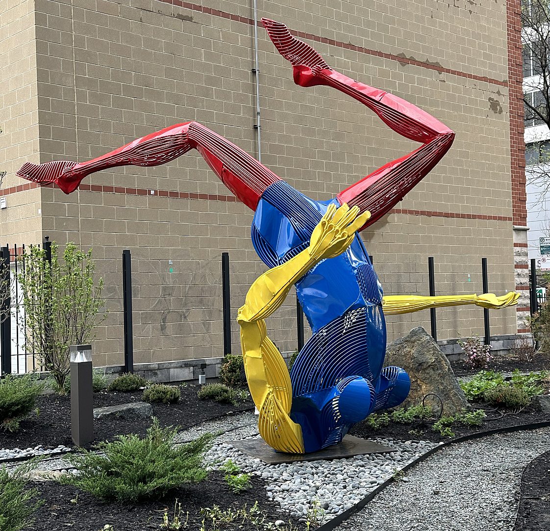

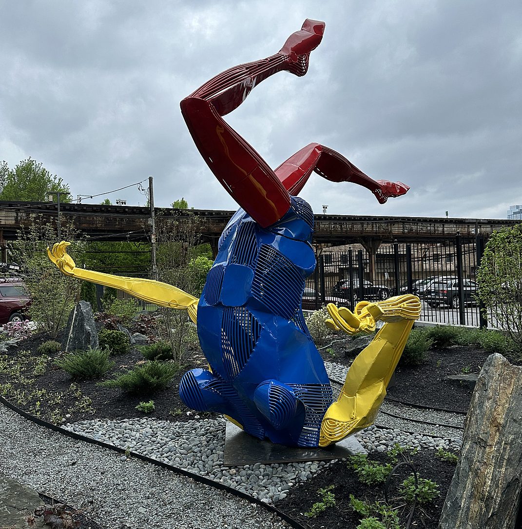

This sculpture was created to express movement through a medium that is inherently still. Hand-formed from round steel bar and shaped sheet metal, the artwork captures the fluidity of human anatomy in motion- freezing a single expressive moment in time. Its sweeping lines and layered contours invite viewers to consider how steel, though rigid and permanent, can be shaped to reflect grace, energy, and life.
The Head in the Sand Sculpture Initiative stands 16 feet tall and consists of five independent sections engineered specifically to accommodate the kettle at the galvanizer’s facility. From its inception, the project required a close partnership between art and engineering, ensuring the piece could be safely hot-dip galvanized without compromising its delicate, expressive form. The sculpture’s underlying structure, an intricate network of ½-inch round bar, introduced unique technical challenges. Each segment needed to maintain dimensional stability throughout the galvanizing process, prompting careful planning to minimize distortion and ensure proper zinc flow. Venting and drainage locations were strategically incorporated into the design so that molten zinc could penetrate the densest areas of the anatomy-inspired framework, fully coating internal and external surfaces. Following galvanizing, the sculpture received a carefully applied duplex paint system to achieve the desired visual finish while further extending service life. The synergy between artistic vision, fabrication technique, and galvanizing expertise resulted in a durable, visually compelling piece capable of enduring decades outdoors- proving how hot-dip galvanizing can support and preserve even the most intricate artistic expressions.
