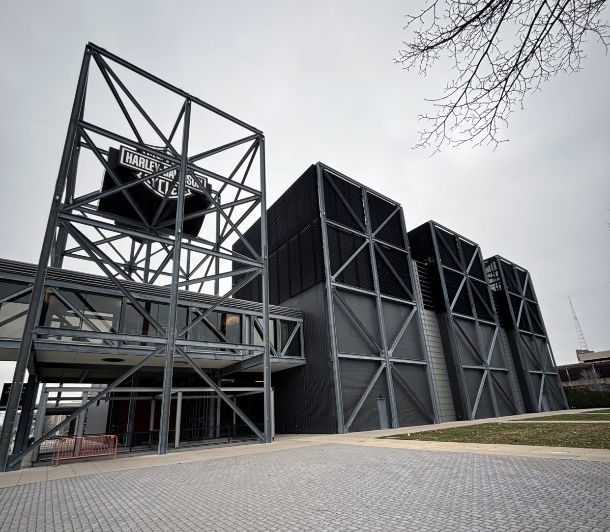

One can almost hear the ripping, throaty roar of a Harley-Davidson motorcycle just by gazing upon the industrial, steel framework of the Harley-Davidson Museum in Milwaukee, Wisconsin. Situated on a 20-acre reclaimed industrial site along the Menomonee River, the 130,000-square-foot museum is a bold tribute to Harley-Davidson’s rich history, engineering excellence, and the culture that has made it a global icon.

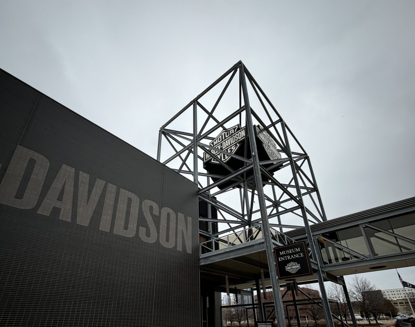

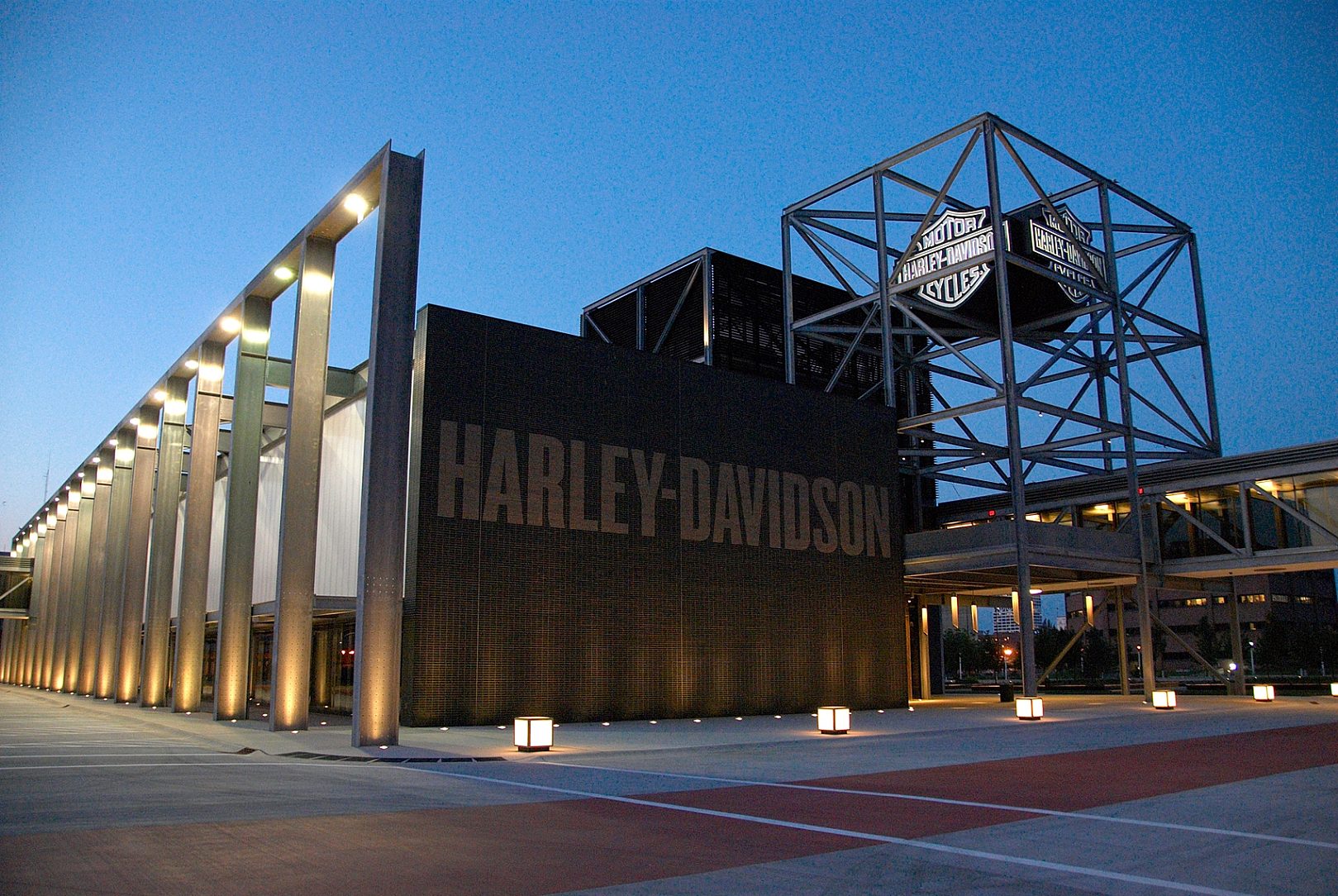

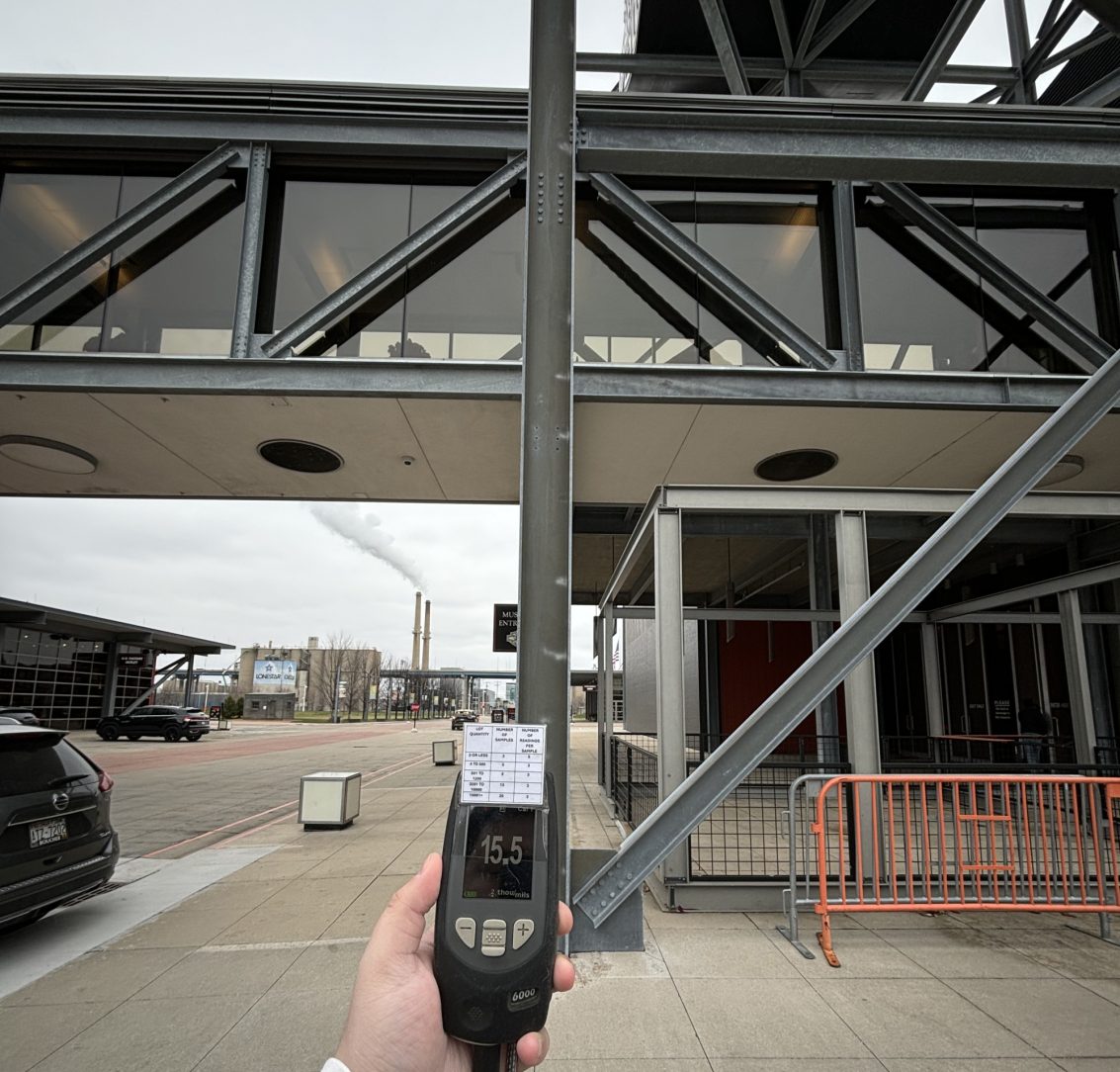

The building’s design features exposed I-beams, columns, gusset plates, and cross bracing, all intentionally left visible to highlight durability and authenticity. To safeguard these elements against Milwaukee's harsh climate, the designers chose hot-dip galvanized steel for its exceptional corrosion resistance, minimal maintenance needs, and industrial aesthetic.

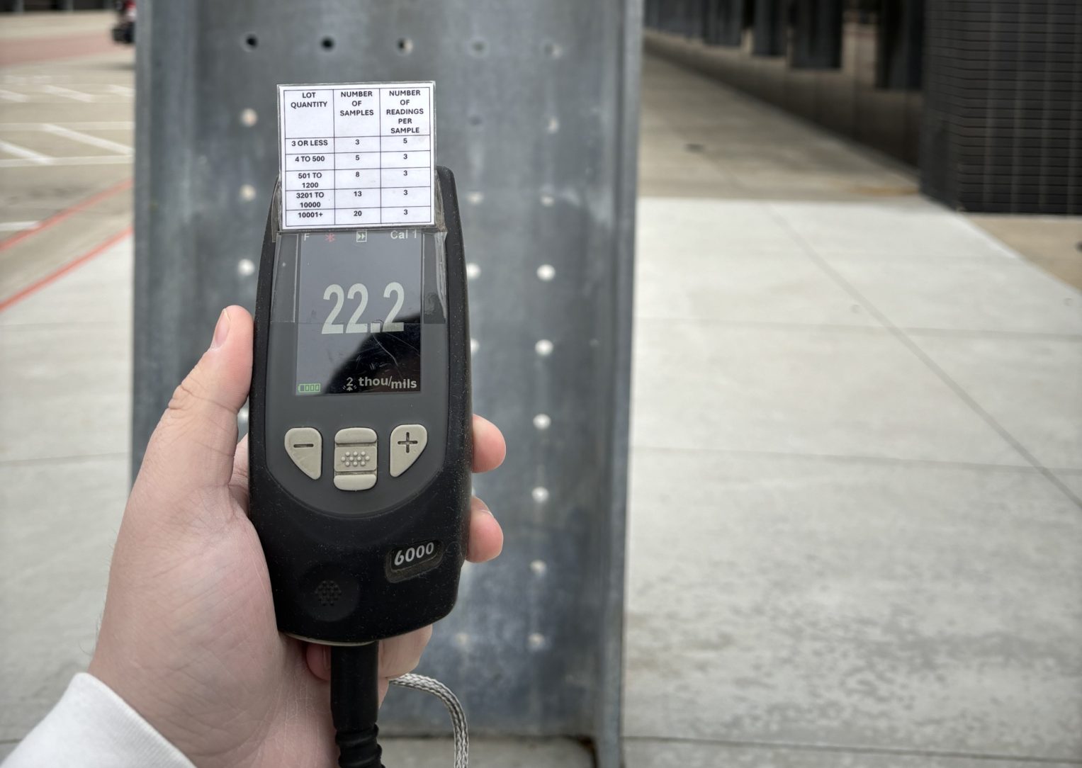

Desc | Read. 1 | Read. 2 | Read. 3 | Read. 4 | Read. 5 | Avg. |
Exterior Column 1 | 22.2 | 23.2 | 21.6 | 21.6 | 19.4 | 21.60 |
Exterior Column 2 | 13.5 | 13.3 | 13.4 | 13.3 | 13.5 | 13.40 |
Exterior Column 3 | 15.5 | 15.3 | 10.8 | 15.5 | 12.2 | 13.86 |
