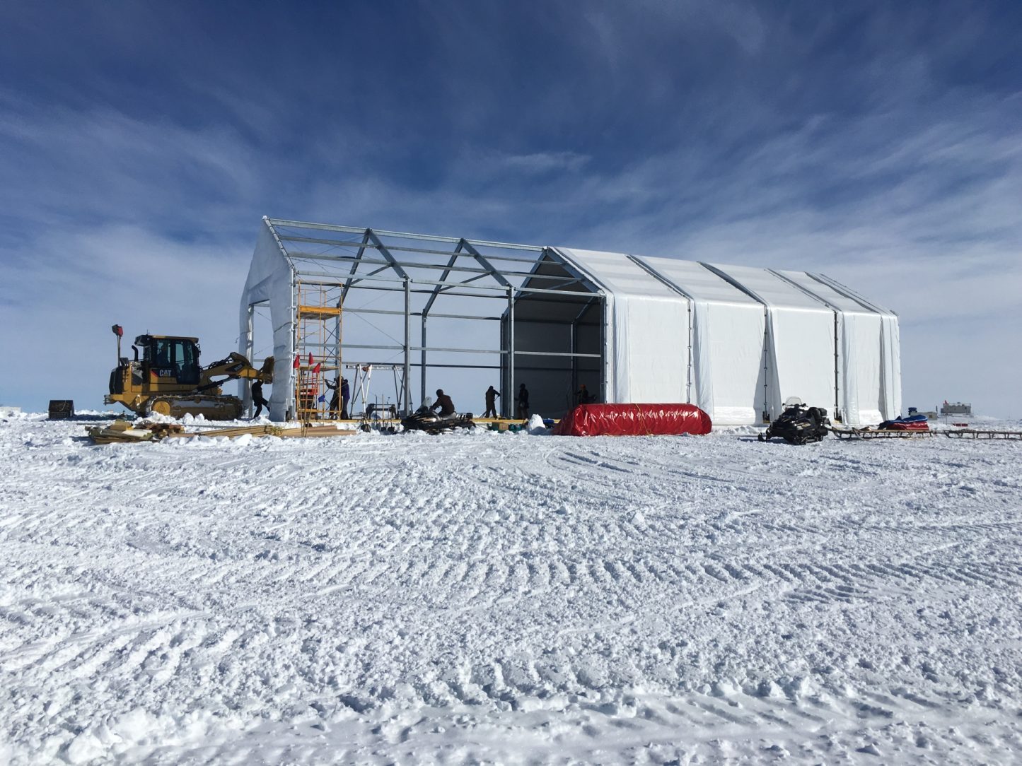

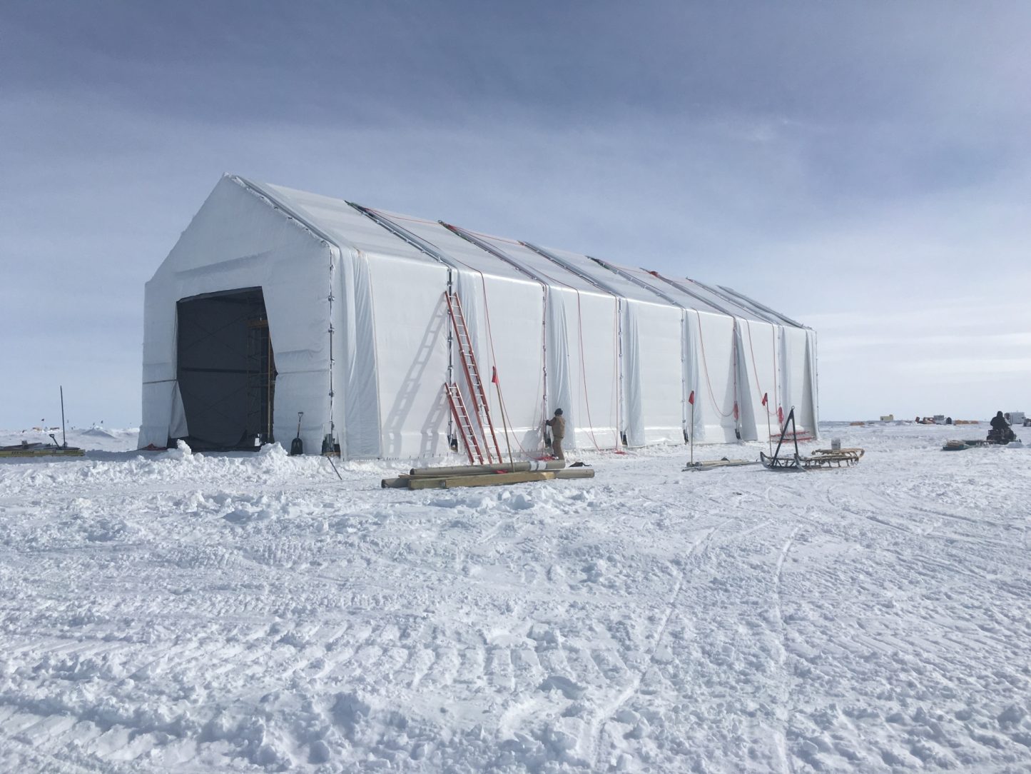

The fabricator provided a 32 ft x 97 ft BVR-type fabric structure engineered specifically for polar use. The building features Thermohall® insulated PVC cladding, delivering an insulation value of R-35 through approximately eight inches of high-density insulation. This envelope protects equipment and personnel while maintaining interior usability in extreme cold.
To address the persistent challenge of drifting snow, the structure was installed on a sled-style wood and steel foundation, allowing it to be moved across the ice when snow accumulation threatens to bury it. After installation, the building was successfully relocated approximately 400 yards, proving the effectiveness of its mobile design.

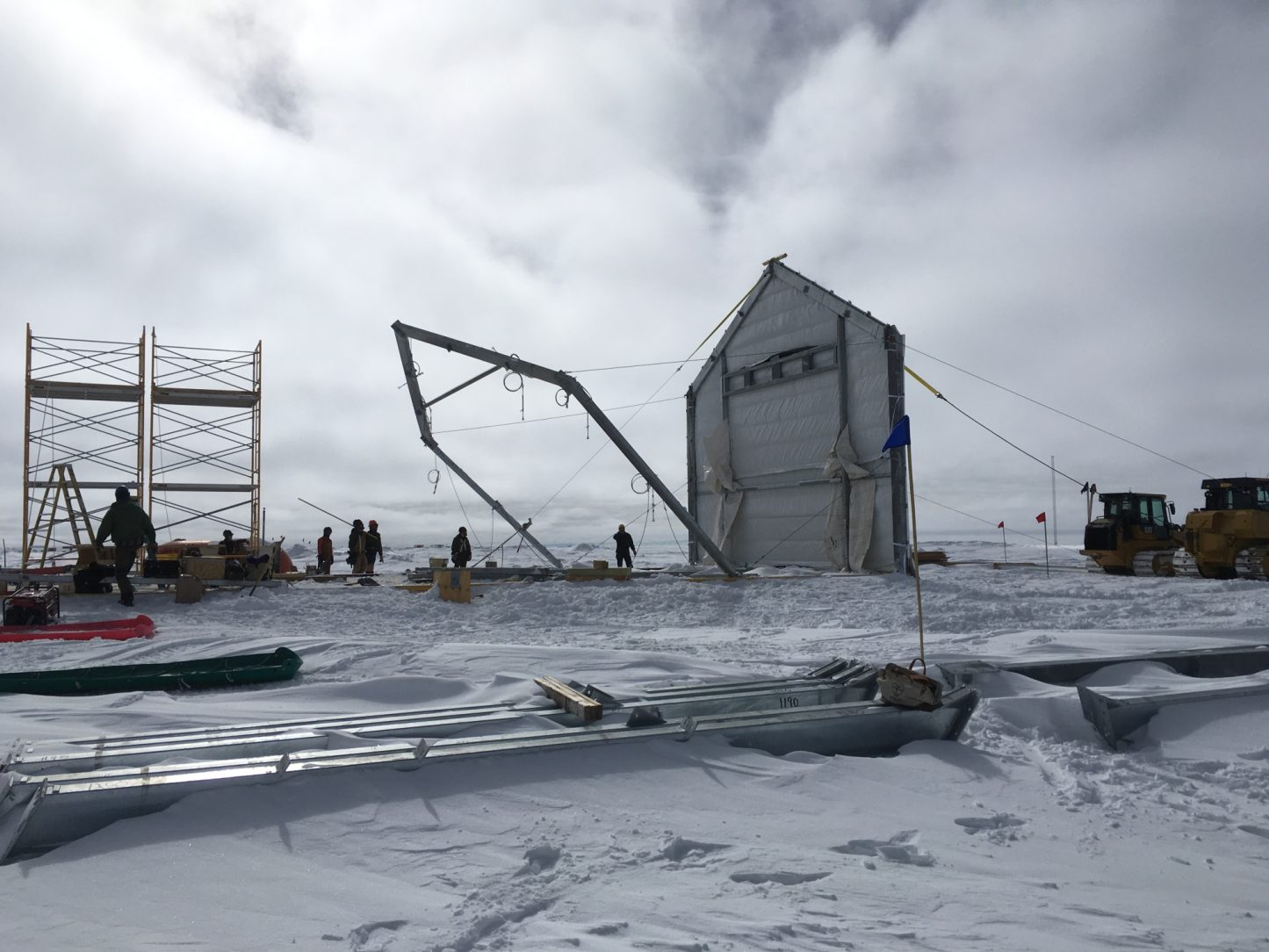

All building components were prefabricated and transported to Greenland via a U.S. Air Force C-130 aircraft equipped with skis, capable of landing directly on the ice cap. Assembly was completed on site with minimal heavy equipment, using snowmobiles and manual methods under demanding Arctic conditions. The construction team lived in temporary polar tents during installation.
