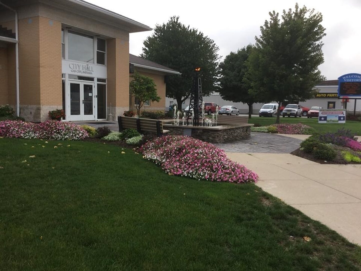

Formerly known as Harrisburg, Gas City is approximately 70 miles northeast of Indianapolis, IN. A supply of natural gas was found in 1887 and the city was renamed in 1892. There was hope to grow Gas City to a population of 25,000 from only 300. This hope dried up when the supply of natural gas ran out in 1904.
Betty and Chap Hutchins were predominate community members during their lives in Gas City. Betty was an art teacher and lived to be 103 years old. Chap’s ashes have been enclosed in the bench at the center of downtown in the Hutchins Pavilion. Upon Betty's passing, she left a significant amount of money to put towards enhancing Gas City. The Betty Hutchins Beautification Committee was formed to oversee the funds and what they would be put towards. The flower pots lining Main street next to the gas derricks street signs are two projects the beautification committee approved. Gas derrick replicas can be found all over the city.Betty and Chap Hutchins were predominate community members during their lives in Gas City. Betty was an art teacher and lived to be 103 years old. Chap’s ashes have been enclosed in the bench at the center of downtown in the Hutchins Pavilion. Upon Betty's passing, she left a significant amount of money to put towards enhancing Gas City. The Betty Hutchins Beautification Committee was formed to oversee the funds and what they would be put towards. The flower pots lining Main street next to the gas derricks street signs are two projects the beautification committee approved. Gas derrick replicas can be found all over the city.

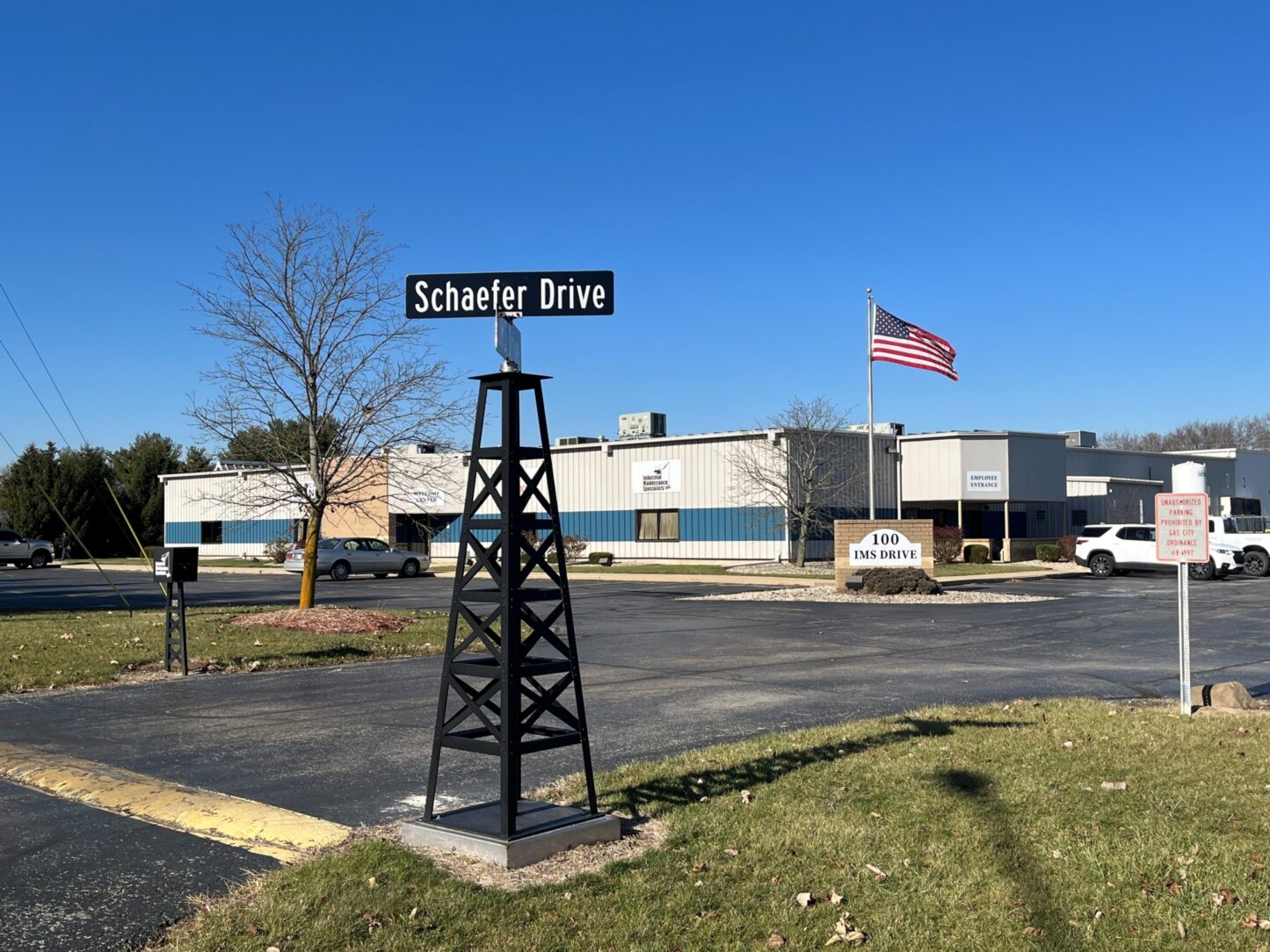

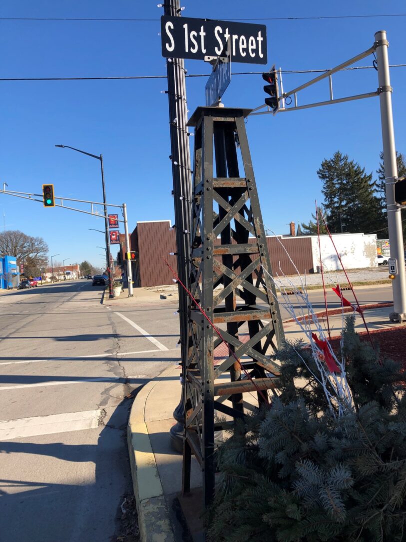

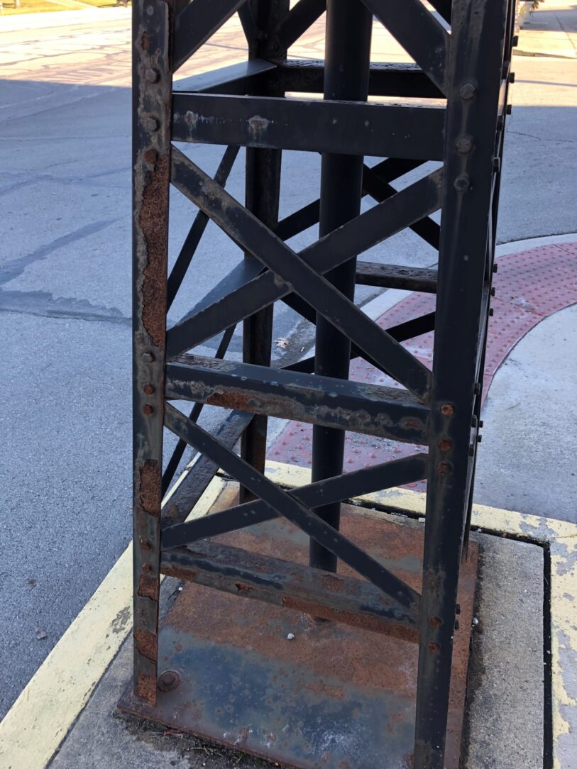

The gas derrick street signs were originally fabricated and installed in 2012. A black powder coating was the choice of finish for the original gas derricks street signs. After 8-9 years in service and subjected to the cold Indiana winters, the appearance was no longer ideal, and the community noticed.

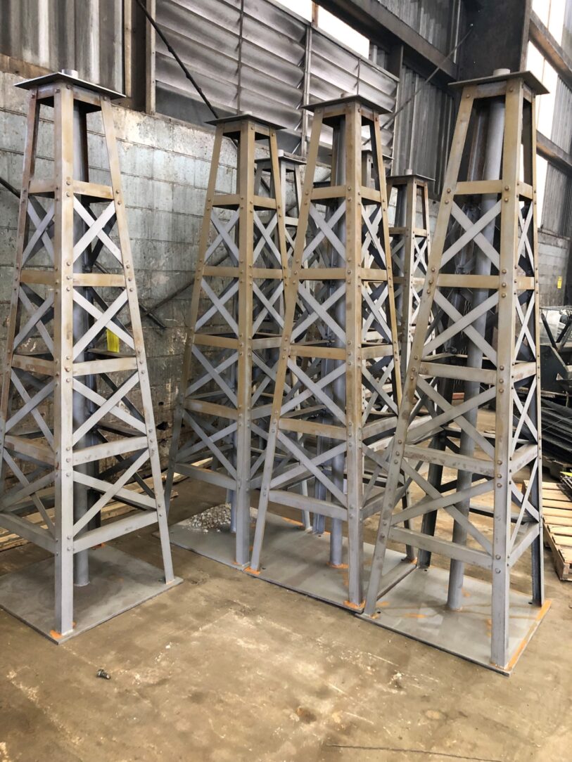

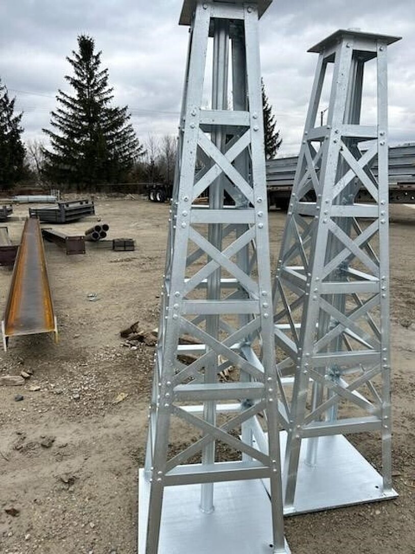

Several complaints lead the committee to search for another coating option that would last longer and protect the original investment. A local general contractor had experience hot-dip galvanizing and started the conversation about corrosion protection with a local galvanizer. After a sample was completed, the black shade of the gas derricks was still desired. The local galvanizer encouraged a duplex coating to give the street signs the black shade without sacrificing the corrosion protection.

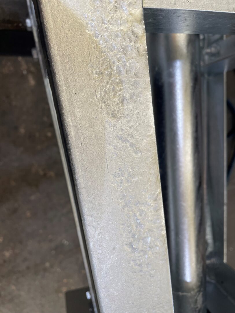

The decision to blast, galvanize, and then powder coat the gas derrick street signs to stop the deterioration of the steel was approved. The project was broken up into two phases with almost a year in between. Jerry Long, former member and chair of the Beautification Committee and Historical Society said, “I wish we would have galvanized these originally so we wouldn’t be going through this process now.”
Deicing chemicals, accidents, and packed up snow are some of the challenges the coating life will face. By galvanizing and powder coating, the synergistic effect will take place offering a superior coating life than powder coating alone. hot-dip galvanizing will minimize the maintenance costs that were experienced in the first ten years. The duplex coating will help to keep the remaining steel intact.
