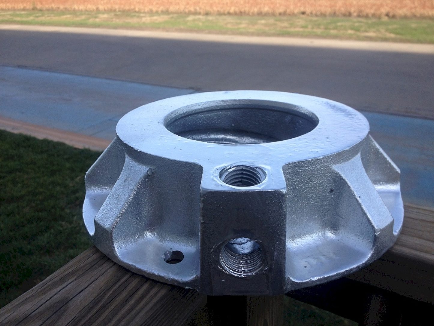

Low Cost Maintenance/Life Cycle Costs Communities want bridges to be in service for long periods of time and without costly, time consuming, traffic flow reducing maintenance. The HDG coated bearing plates in the post-tensioning system had an average coating thickness of 7 mils. The HDG coating life expectancy of these bearing plates exceeds the target set by the designers. Encased in concrete, the HDG bearing plates will not require any maintenance for decades.

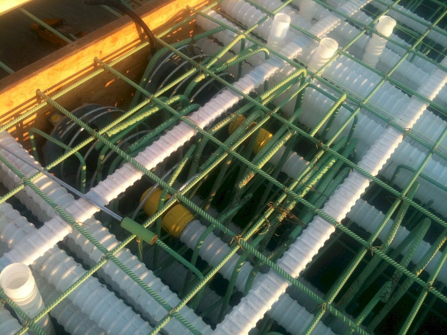

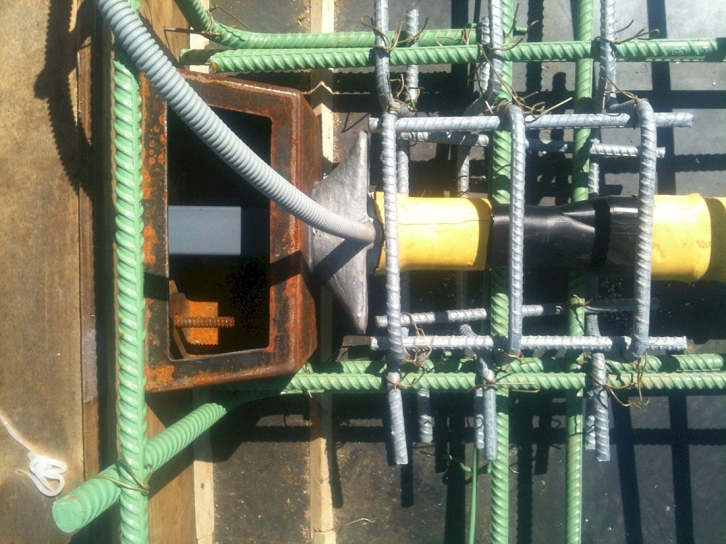

The post tensioning bearing plate and surrounding rebar.
