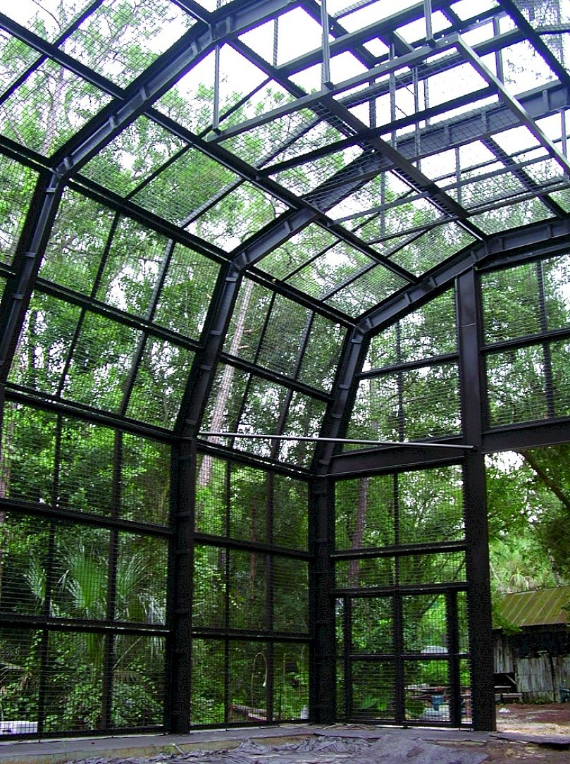

It was also necessary for the structure to be hardy and durable, as the apes will scratch, chew, and abuse any building material. The humid coastal environment, corrosive ape wastes, and continuous habitat cleanings also would provide extreme challenges for corrosion protection. A duplex system of paint over hot-dip galvanized steel was the ideal solution to meet all of these needs.
A duplex system combines the superior corrosion protection of galvanized steel with the additional benefits of another corrosion protection system, such as powder coating or paint, to extend the life of the piece even further. It also allows you to match your project to a specific color scheme, if desired. For the Center, Ragan wished to paint the project in shades of green and brown in order to help the structures blend with the natural environment, without sacrificing the long-lasting, maintenance-free durability provided by galvanized steel.
The durable zinc coating of the galvanized steel is extremely difficult to penetrate, with zinc-iron alloy layers of up to 250 DPN hardness protecting the steel beneath the coating. This means the galvanized steel can stand strong against the gnawing and pounding of the apes, unlike paint alone, which would simply flake off and be rendered ineffective for corrosion protection. The cathodic protection created during the galvanizing process also helps to this end. Cathodic protection means the zinc will ionically sacrifice itself to protect areas around small scratches- preventing rust and corrosion from spreading like wildfire across a structure upon the first small breach.

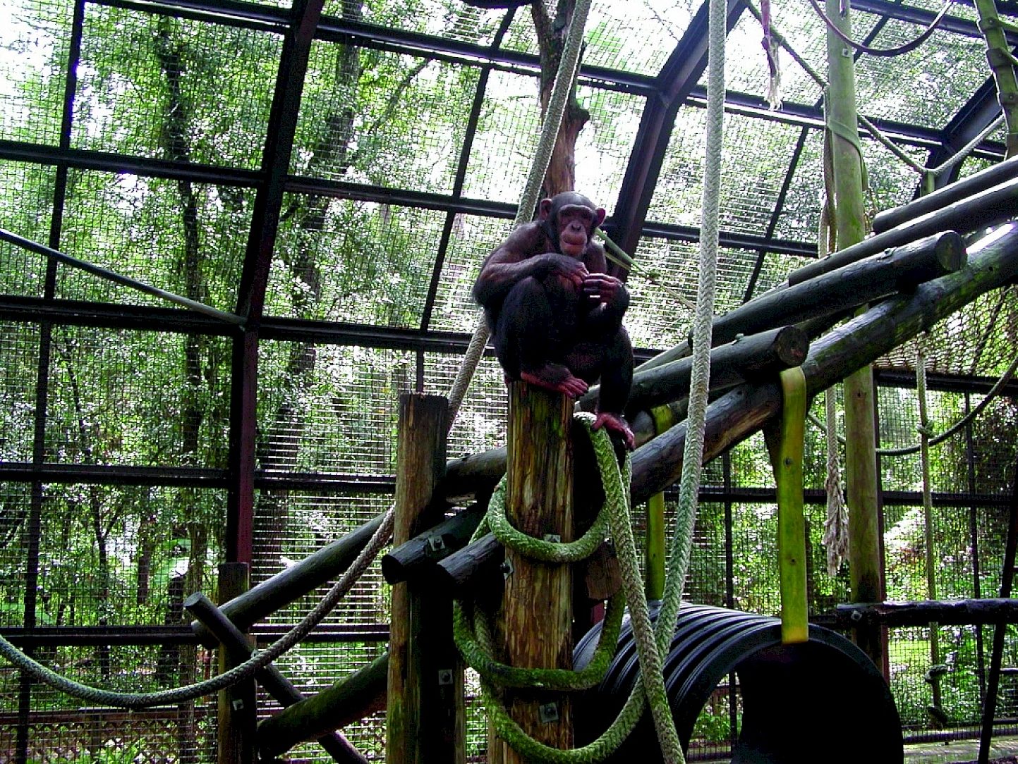

The habitat areas are large domed or barn-shaped structures made of hot dip galvanized steel beam, angle, channel, and plate, with heavy wire mesh used to create the side panels. Inside the habitats you will find an assortment of toys and swings, where the apes spend their days playing, eating, and napping. There is a concrete night house equipped with hot dip galvanized steel cages where the apes go at night to sleep, as well as a veterinary clinic on site.

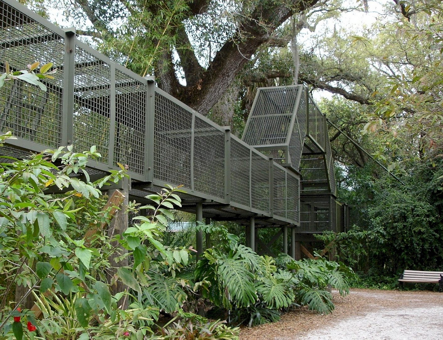

The clinic, night house, and all habitats are connected by a system of chutes and walkways elevated 10 15 feet above the ground to give the apes the feeling of traveling through the trees. These chutes and walkways are also made of hot dip galvanized steel angle, channel, and mesh. They have tracks made of galvanized flat bar welded down the lower inside portion of the walkways in order to give the apes a smooth surface for walking.
