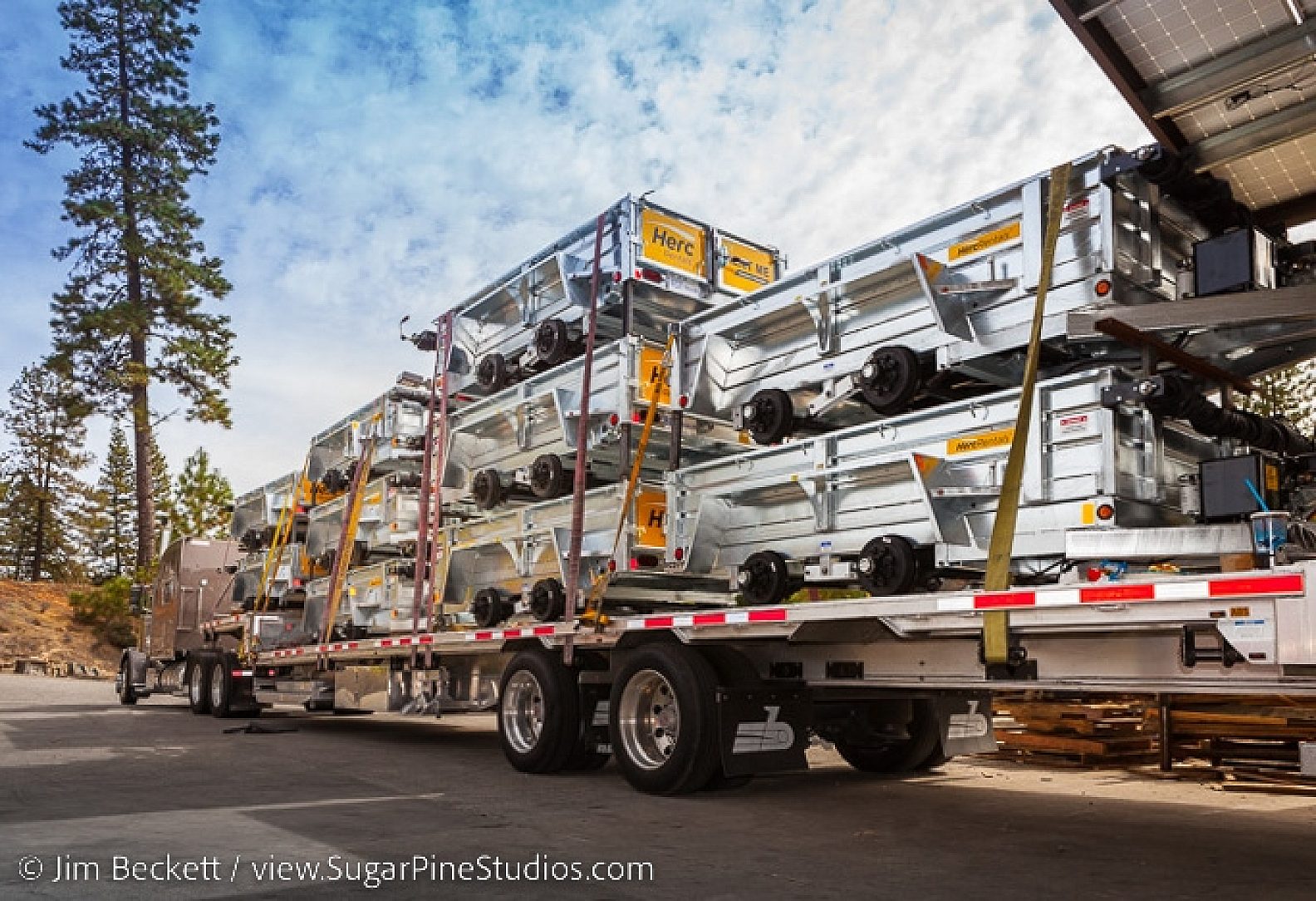

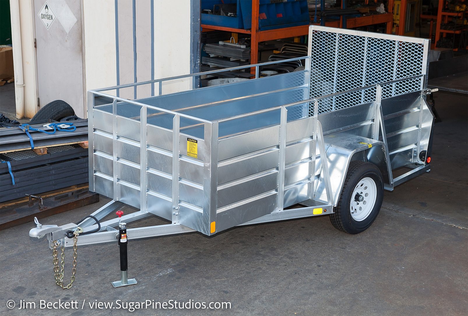

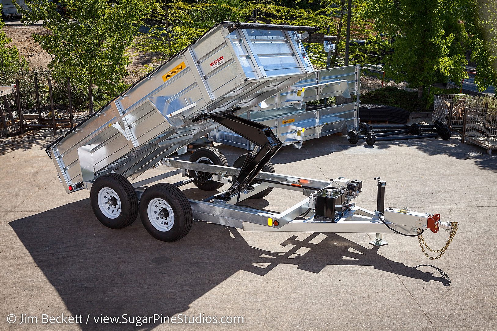

Today, Best Trailer supplies many of the top rental companies—Sunbelt, Herc, Ahern, and United—with galvanized trailers. To ensure exceptional quality, Best Trailer lasers, forms, and constructs each trailer entirely in-house, using 3/16” thick plate for the walls and floor, reinforced with two-by-four rectangular tubing and sturdy channels for the base and tongue.
In partnership with a skilled galvanizer, Best Trailer ensures that these trailers are built to last. Working closely together, they followed ASTM A384 and ASTM A385 standards to galvanize each trailer as a single unit, avoiding the need for post-galvanizing assembly. This collaborative approach results in superior corrosion protection and a turn-key product, with the entire trailer tub, base, and tongue dipped as one piece to maximize durability and streamline assembly.
