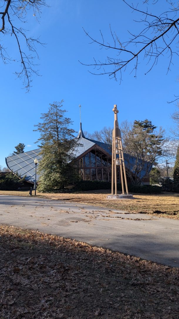

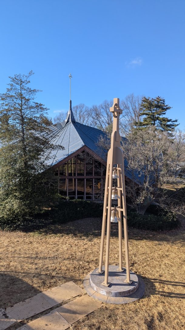

St. Matthew’s Episcopal Church provides a caring, inclusive community, centered in the Eucharist and grounded in the Gospel for residents of Louisville, KY and the surrounding area. As a call to worship and welcome to guests, a new bell tower chimes across the congregation. The tower, equipped with three new bronze bells will stand as a landmark of the church through decades of weddings and worships thanks to the galvanized tower they are installed in.

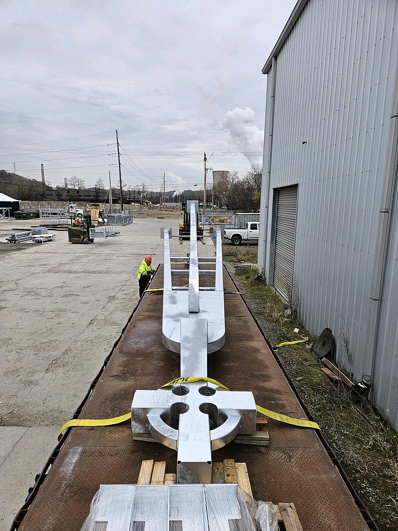

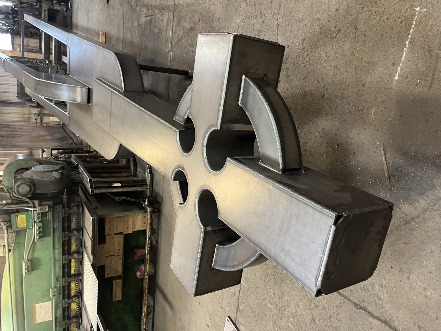

The project didn’t come without its challenges, however, the galvanizer and fabricator were able to work closely together to solve them. Since the tower was designed as a single weldment, significant venting issues had to be addressed without compromising the tower’s aesthetics. Additionally, the size of the tower provided a challenge in locating a galvanizer with adequate capacity. From the time the galvanizer was contacted, they were able to simplify the process. They prepared vent and drain hole guidance to ensure quality results and even provided round-trip transportation.
The new bell tower at St. Matthew’s Episcaopal Church is now a predominant feature on the property. The investment in duplex coating the structure will ensure it is protected from corrosion, so it can ring in the call to worship for decades to come.
