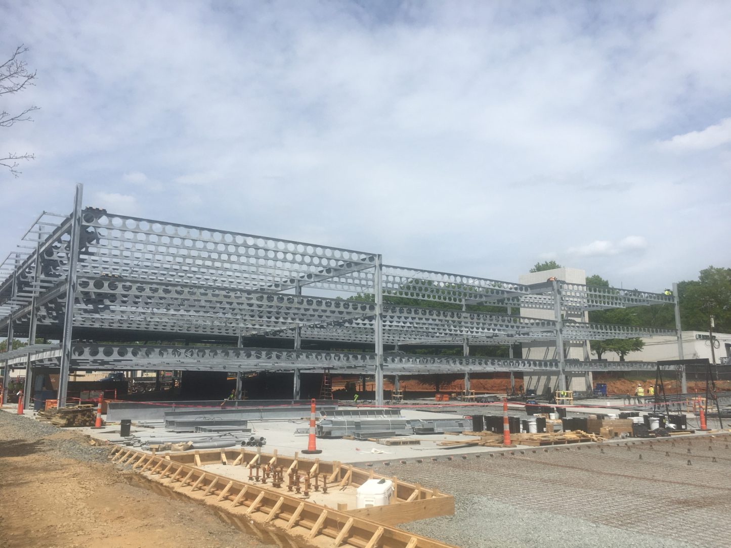

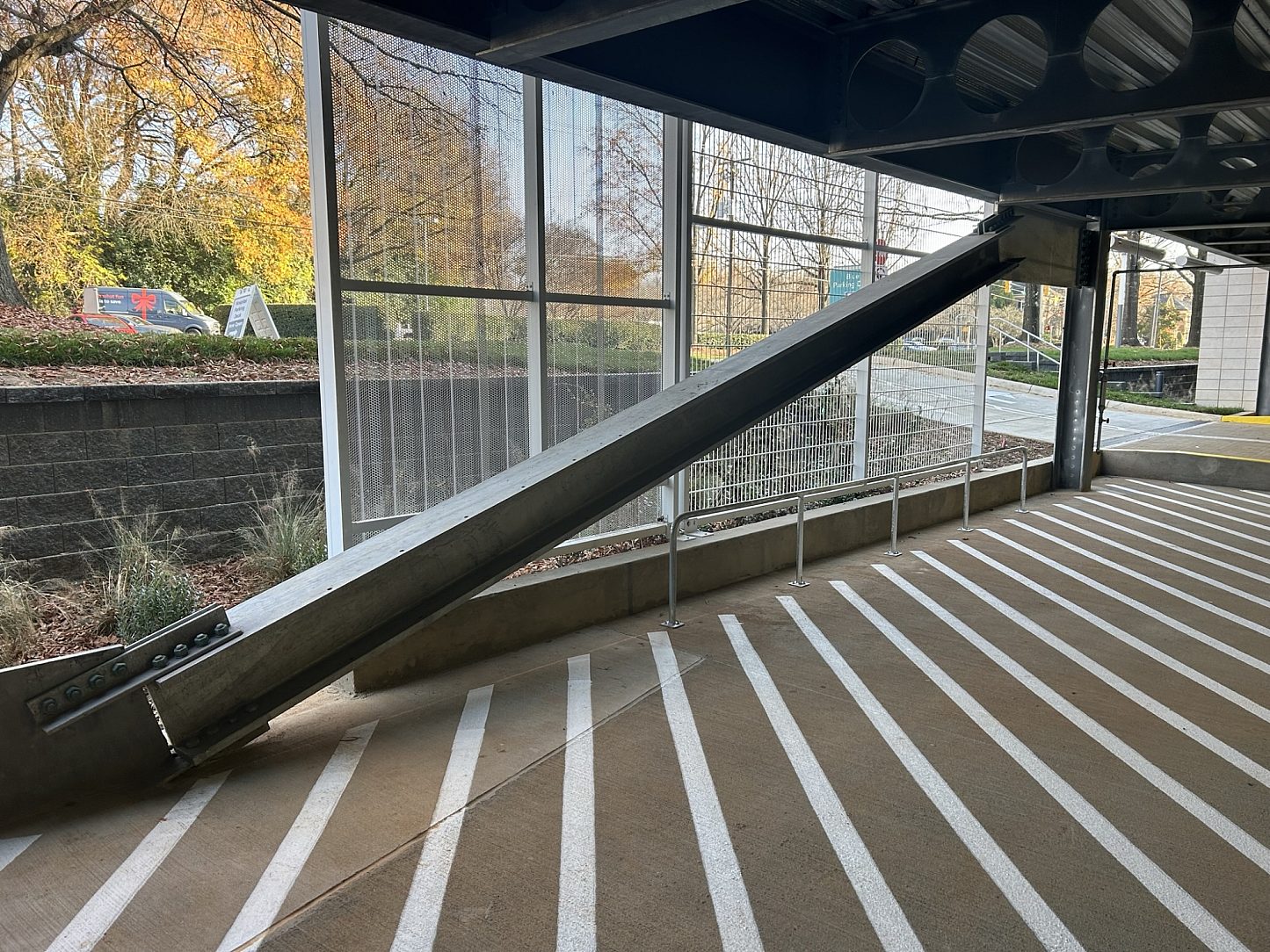

All of the structural steel columns and beams erected and designed into the parking deck project were specified for HDG. Several column members, connecting support beams, along with most of the cellular beams were designed at lengths of more than 62 feet. This length required members to be progressively dipped in the galvanizing kettle. Progressive dipping of these large members proved to be another design element that created savings for this large project.

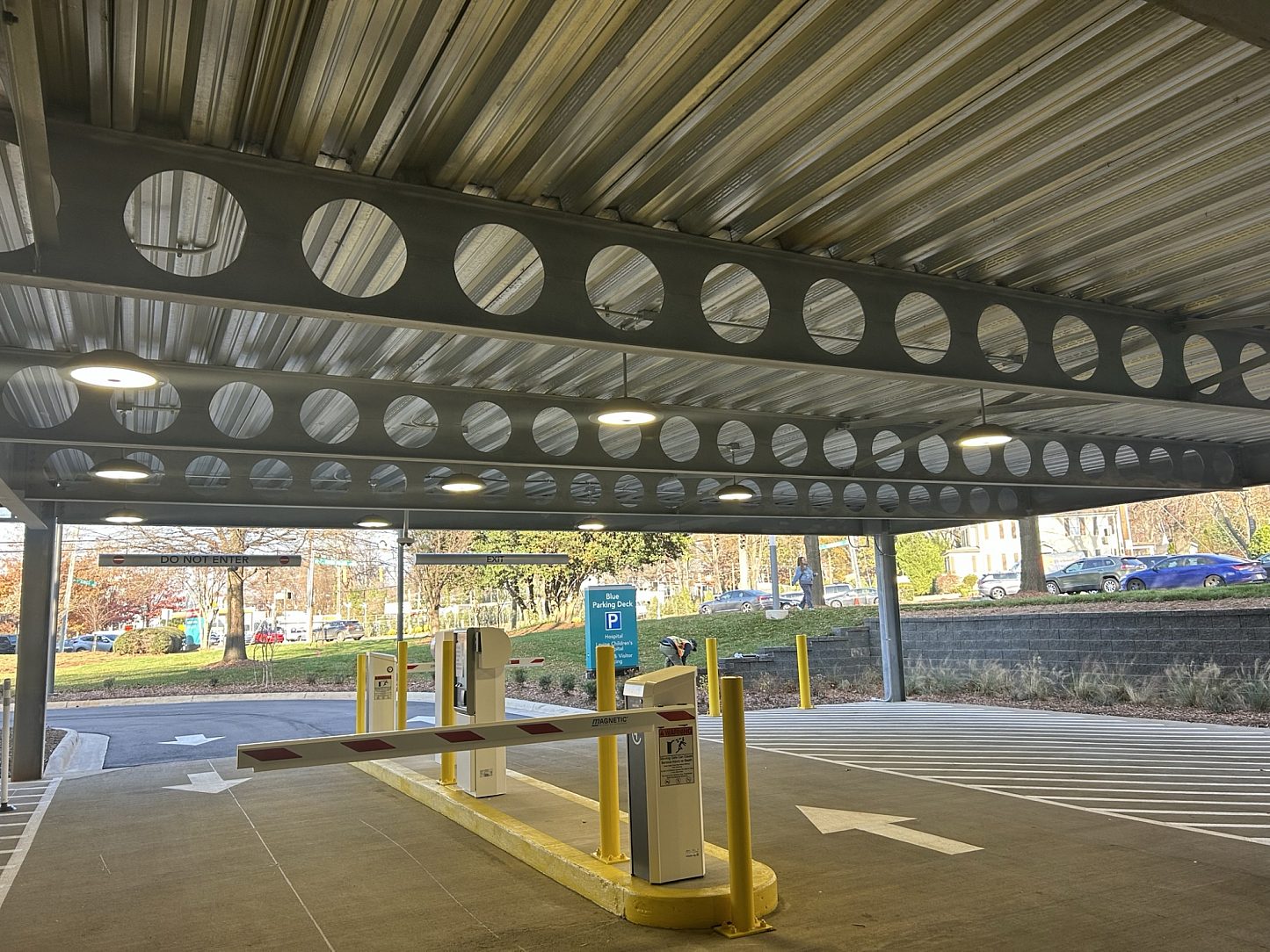

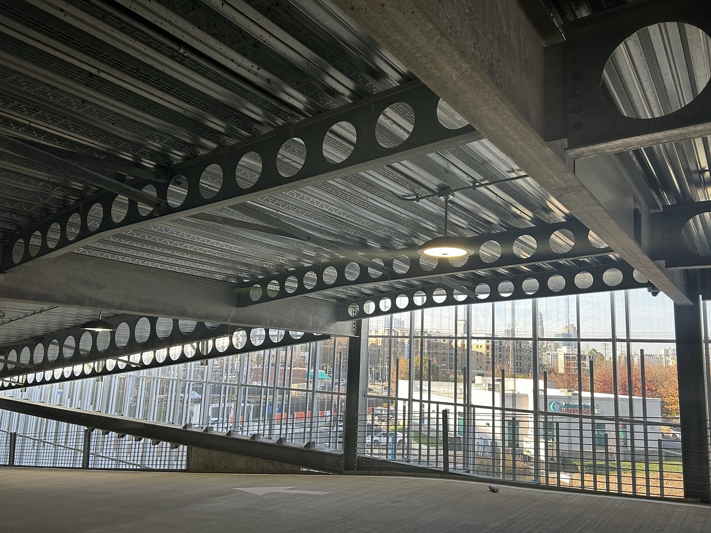

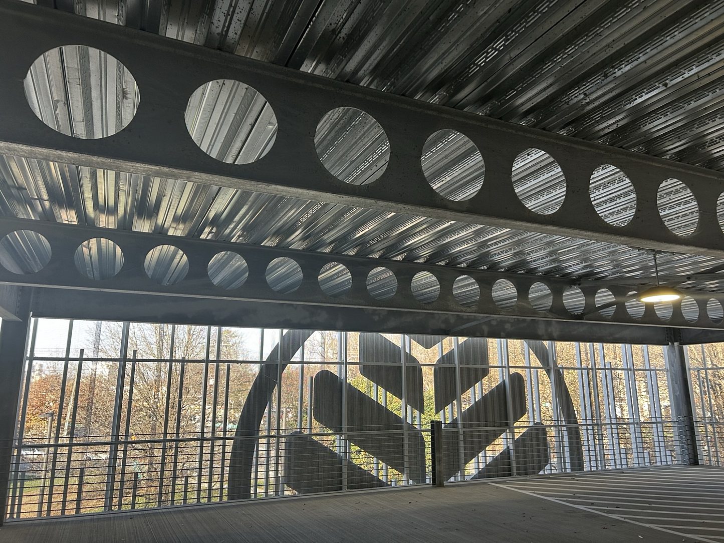

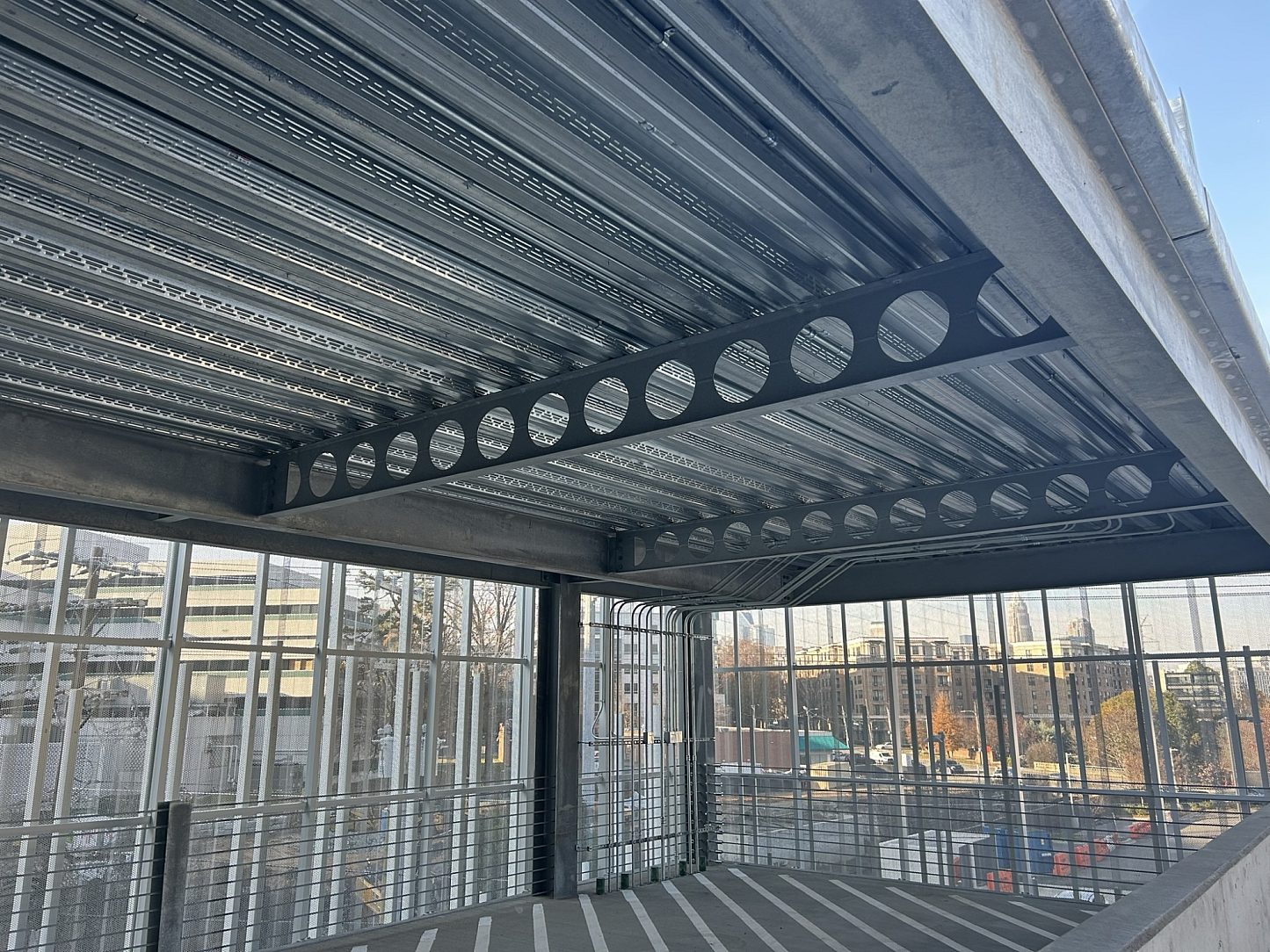

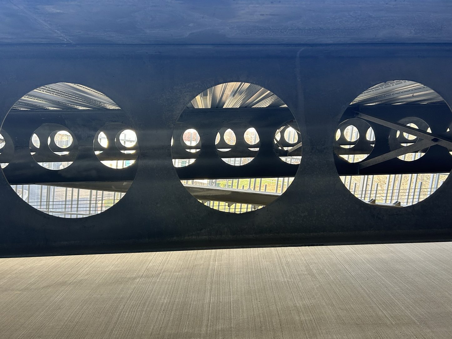

One of the major supporting longitudinal design elements of this project was a special proprietary C Beam. C Beams, also known as cellular beams, are created by cutting a normal structural steel beam down the middle, using both a straight line and a semi-circular pattern. The beam is then separated and offset, then welded back together. This offset welding creates a circular pattern throughout the middle of the beam, and results in a taller, deeper beam than the original steel beam it was cut from. The steel voids that create project savings are made when the larger depth of the C Beam is used in lieu of designing from the same depth of a normal solid steel beam. Over 44 loads of C Beams were designed for this project to create a large savings in steel costs for the project.
The C Beams were not the only source of savings designed into this project. All of the structural steel columns and beams erected and designed into the parking deck project were specified for hot-dip galvanizing. Several column members, connecting support beams, along with most of the cellular beams were designed with lengths over 62 feet, requiring some progressive dipping in the galvanizing kettle. This process requires these members to be dipped into the molten zinc once, and then taken to an area for cooling. Next, after the beams have cooled, the team members will grind on the first dip line, and then place the steel beams back into the kettle for the second dip getting the full zinc coverage required for specification.
