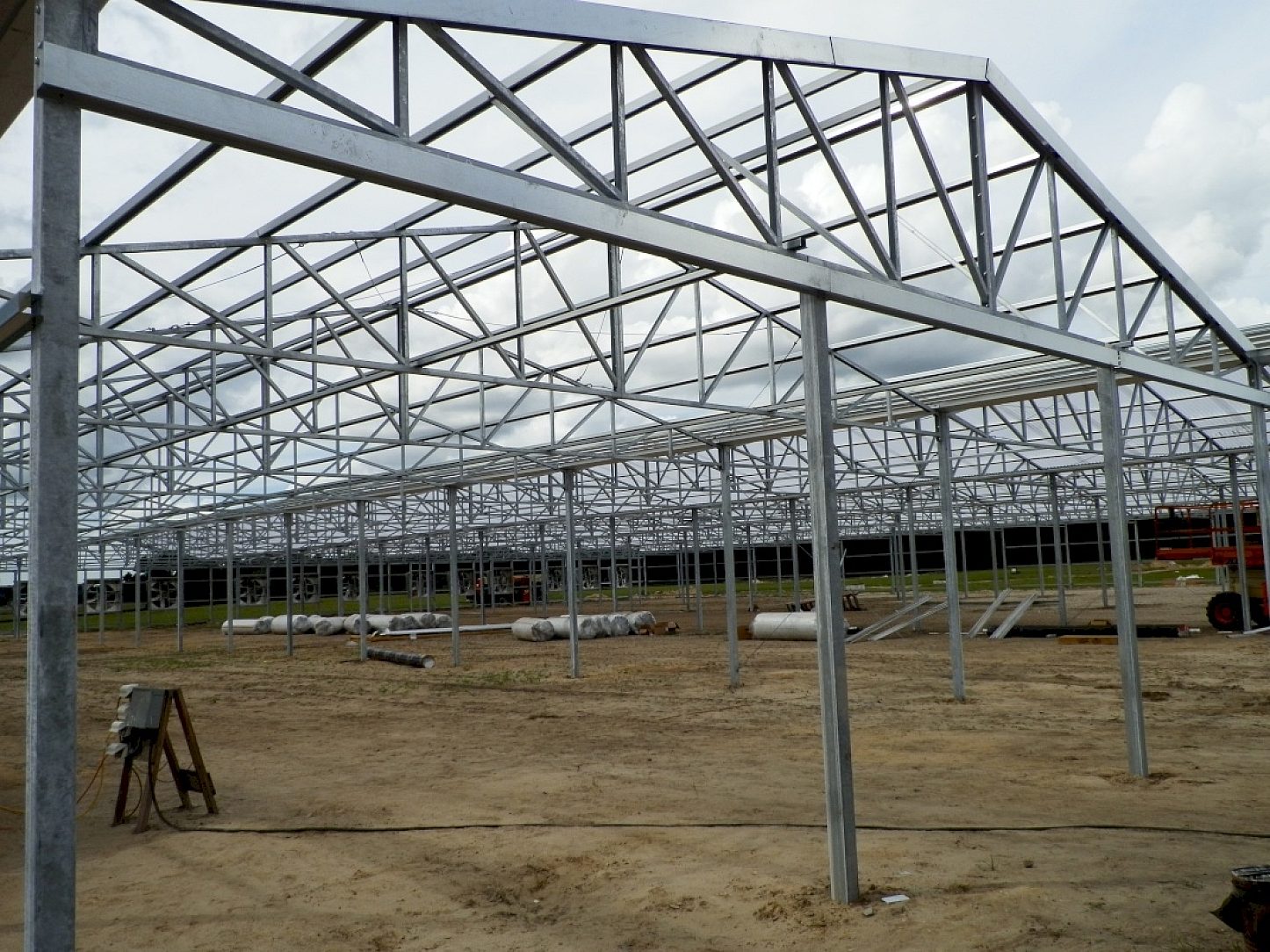

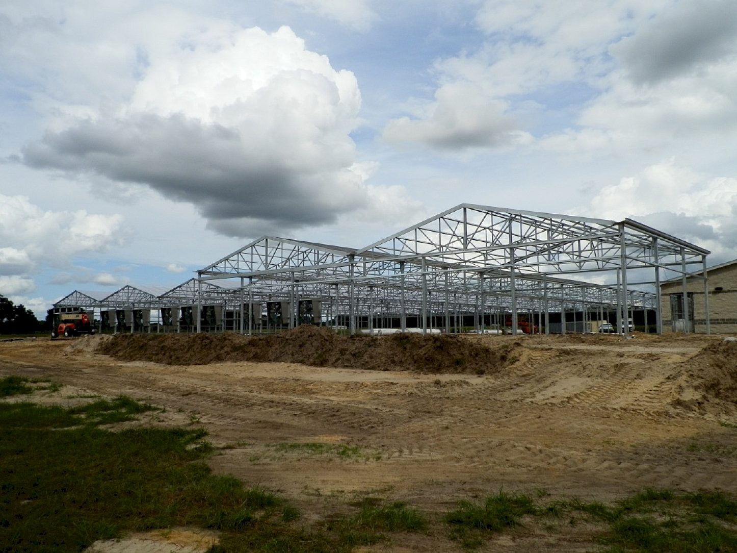

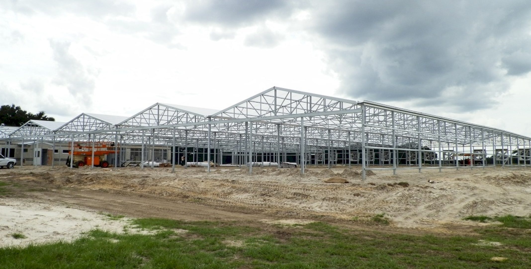

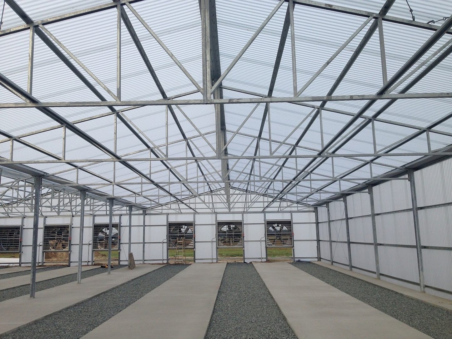

Imperial Builders, a leader in nursery, greenhouse, and warehouse manufacturing and construction, was selected to build the new research facility. The facility contains six greenhouses and a tissue culture lab. The use of pre-galvanized tubing and materials is very common in the greenhouse manufacturing industry, but Imperial Builders has chosen to set themselves apart by utilizing after-fabrication hot-dip galvanizing (HDG). The very nature of a greenhouse is to develop a warm, humid environment which is extremely detrimental to steel structures. Add in the consistent irrigation of the plants and the tropical Florida climate, and a quality corrosion protection system is a must. HDG's cathodic protection will ensure the corrosion resistance needed in this environment. The cost savings accrued from the long life and minimal maintenance that hot-dip galvanizing provides, will allow Agromillora to further invest in research and development for a cure to this disease.
Imperial incorporated galvanizing with the columns and any heavy structural members of the greenhouse. Imperial worked with their galvanizer to utilize HDG in more areas of their buildings providing them a superior total package to offer their customers. One area of concern were the truss sections, which are manufactured with lightweight material and potentially subject to distortion during the galvanizing process. After consulting with the galvanizer, Imperial was able to change the design to manufacture the trusses using u-channel shapes leaving gaps wide enough to allow air and liquids to flow freely throughout during galvanizing. With the new design and special care by the galvanizer to hang the trusses in a manner to minimize distortion, they were galvanized successfully. This is a testament that with proper design, manufacturing considerations, and consultation with the galvanizer, lightweight products can be successfully galvanized.
