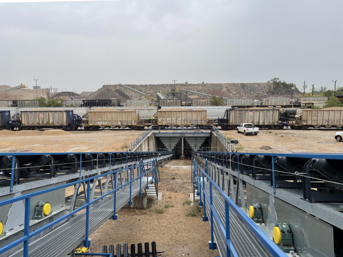

This aggregate processing facility, operated by Vulcan Materials Company, was constructed to expand production capacity in response to the rapid growth of construction across the Dallas–Fort Worth region. The plant supports the increasing regional demand for aggregate materials used in roadway infrastructure, commercial development, and residential construction. By enhancing throughput and operational reliability, the facility plays a critical role in supporting continued economic development throughout North Texas.

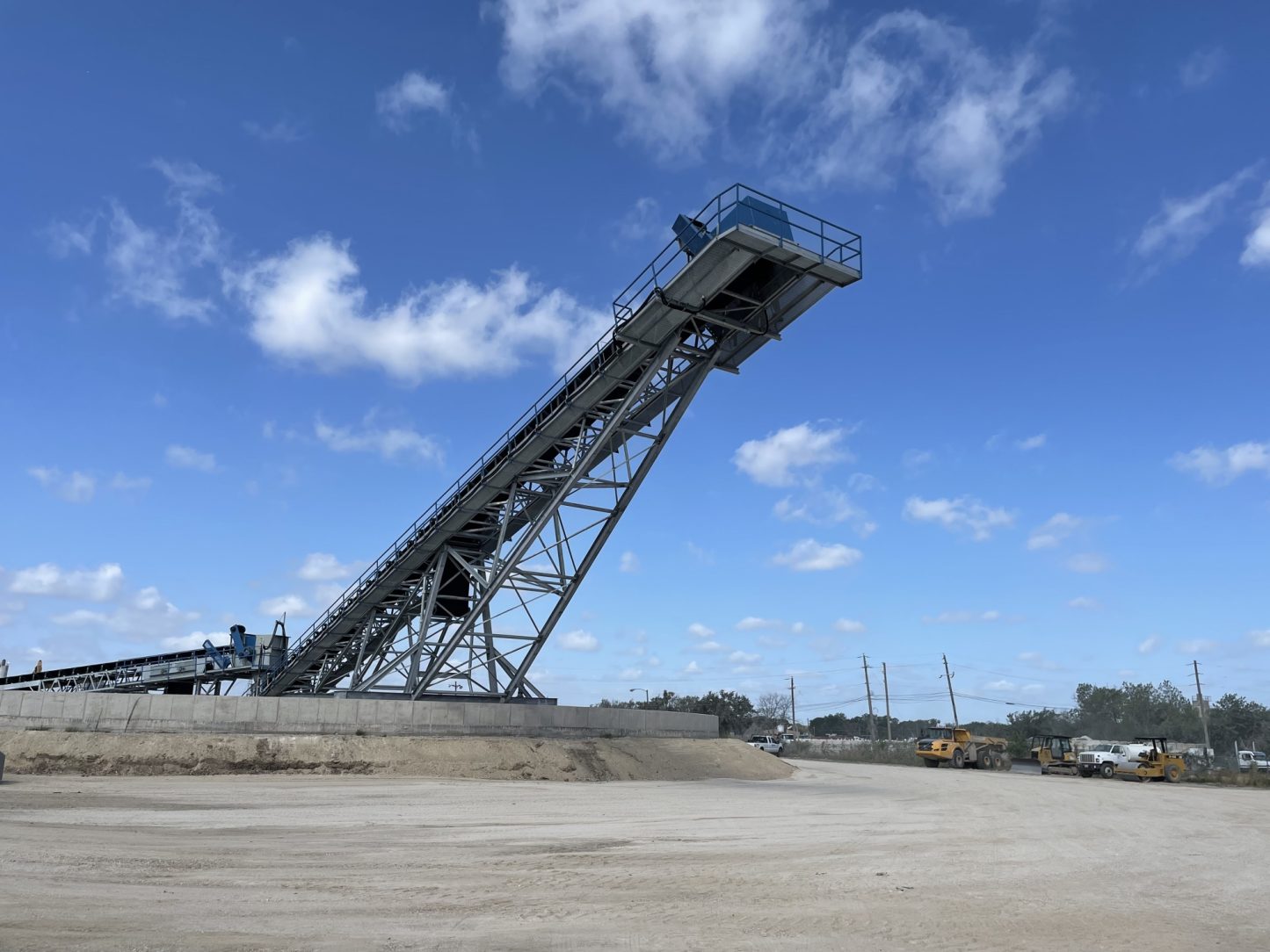

Vulcan Materials’ principal product, aggregates, is essential to nearly all types of public and private construction and serves as the primary raw material for both asphalt mix and ready-mixed concrete. Plant Fabricators Inc., a leader in the design and fabrication of aggregate processing systems, provided the majority of the steel components that make up the crushed stone production facility. Their expertise spans ready-mix plants, sand and gravel operations, and aggregate facilities throughout Texas and the southern United States.
Aggregate plants in Texas operate in severe service environments where exceptionally hard water is used to wash material prior to crushing and screening. This water repeatedly contacts conveyors, support frames, chutes, and structural steel throughout the facility. Continuous exposure to moisture, mineral deposits, and abrasive material creates highly aggressive corrosion conditions, particularly for moving steel components and load-bearing structures.

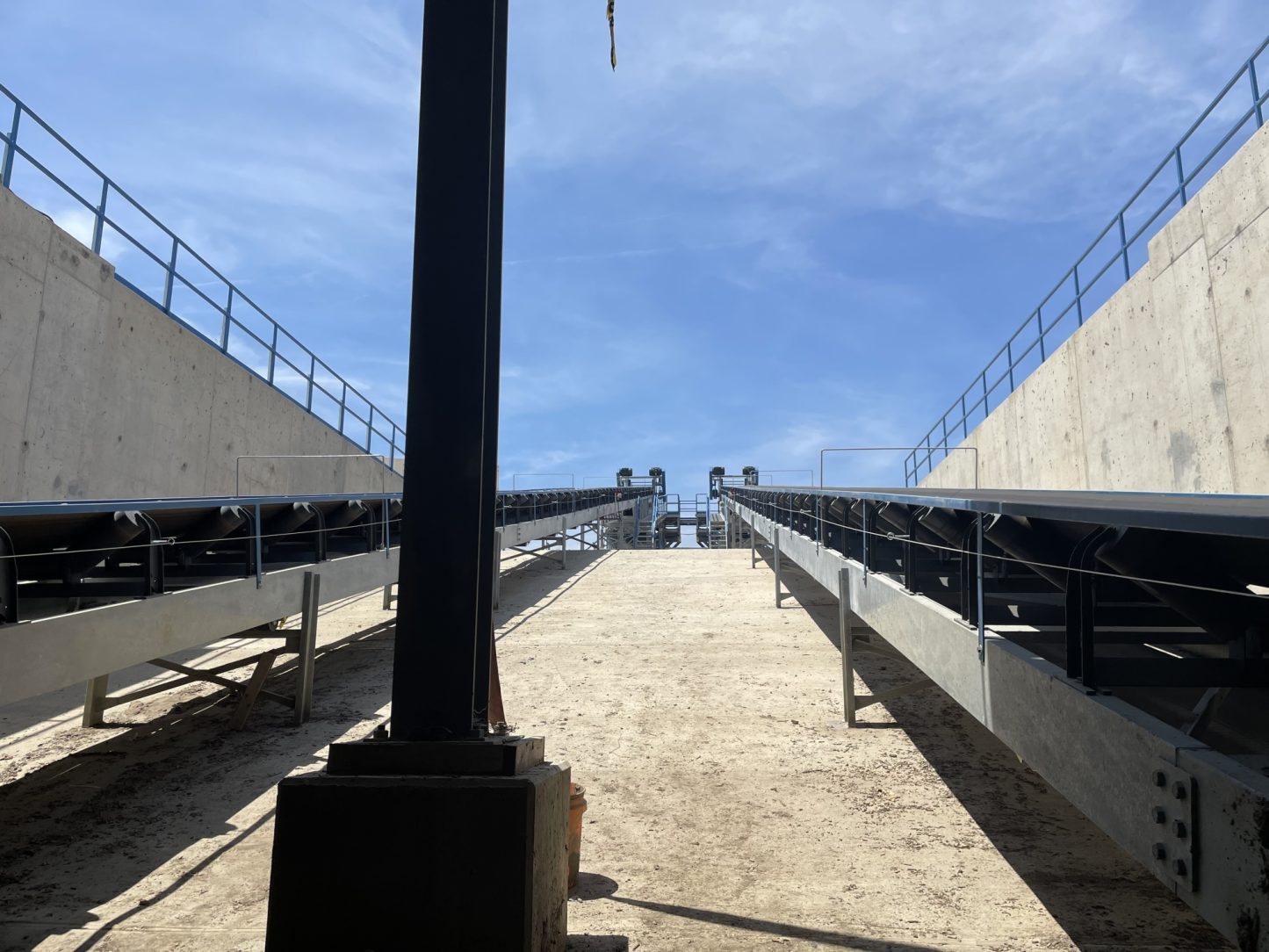

For this facility, hot-dip galvanizing was specified to protect steel components throughout the plant, ensuring durability in the harsh, high-moisture environment created by aggregate washing operations. The zinc coating provides complete metallurgical protection, shielding both exterior and interior surfaces from corrosion while eliminating the need for repeated recoating cycles.

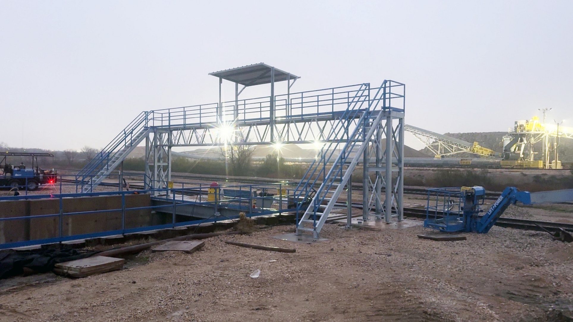

In addition to processing equipment, Plant Fabricators Inc. was also tasked with designing a small bridge to span an open section of the conveyor system. This bridge supports the weight of rail cars loaded with aggregate material and is subjected to the same corrosive water exposure as the rest of the plant. With heavy structural steel members carrying dynamic loads, long-term corrosion protection was critical to maintaining structural integrity and operational safety. Hot-dip galvanizing was selected to provide robust protection for this bridge, ensuring decades of service without significant maintenance interruption.
By selecting hot-dip galvanizing over traditional paint systems, this project dramatically reduced long-term maintenance demands and the risk of production shutdowns. The galvanizing system delivers consistent corrosion protection in an environment where painted coatings would rapidly fail, significantly lowering total ownership cost while improving plant uptime and operational reliability.

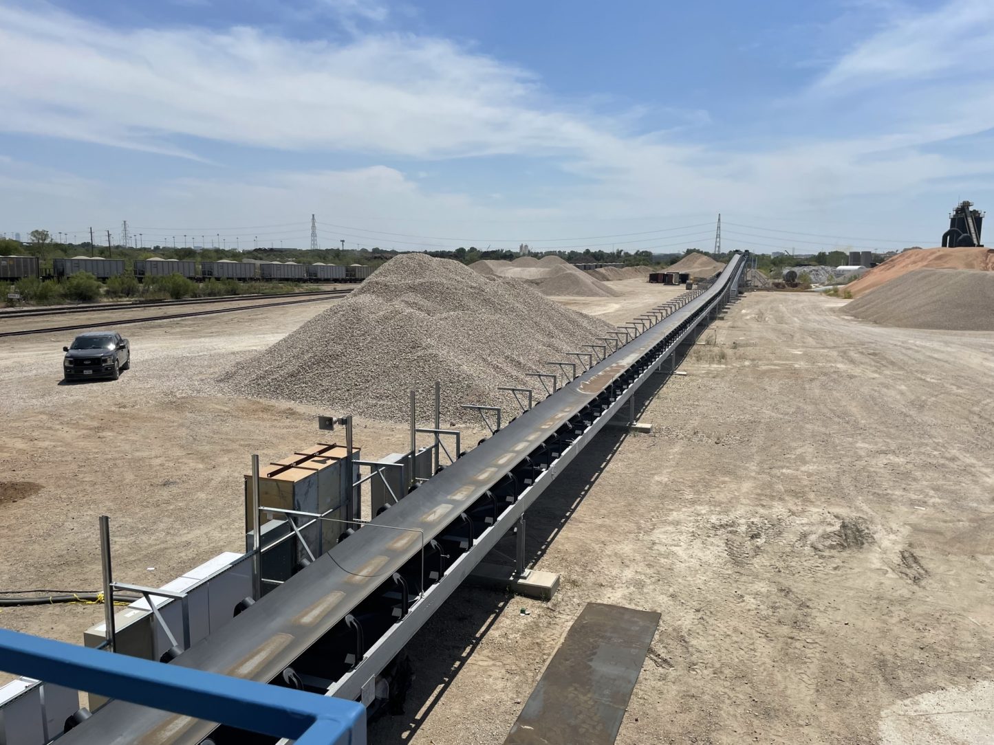

* Conveyor truss sections
* Rail Bridge Structural C500omponents
*Conveyor Supports
*Conveyor Walkways
