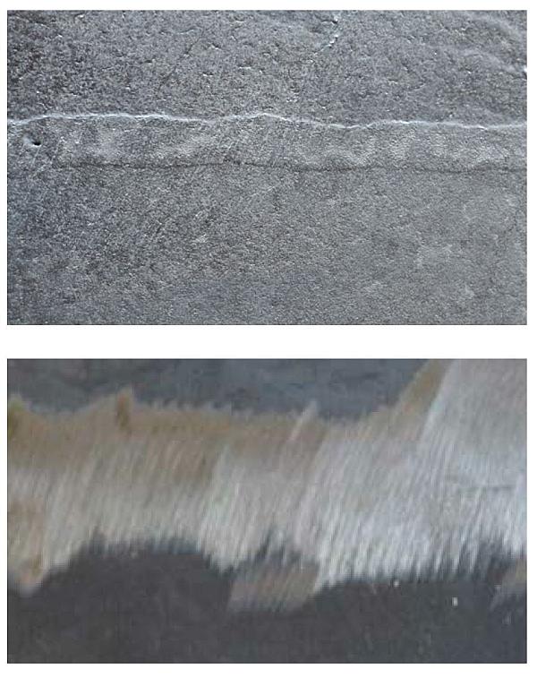

Figure 6 progressive
Figure 6: Progressive dip overlap line (C.17)

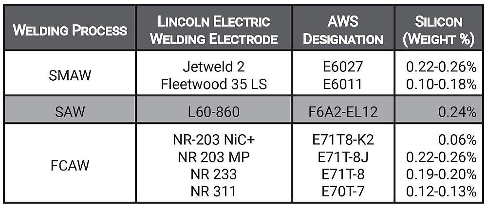

When welded items are galvanized, two factors have the greatest impact on coating quality and aesthetics: cleanliness of the weld area and metallic composition of the weld. Welding slag, flux residues, and welding sprays (with the exception of water-soluble sprays) must be fully removed prior to galvanizing. Welding electrodes high in silicon (>0.25% Si) may cause excessively thick and/or darkened galvanized coatings to form over the weld. When smooth products are welded using high silicon electrodes, the coating over the weld material will be thicker than the surrounding coating, causing a raised weld in an otherwise smooth product. This appearance, sometimes referred to as a “raised weld” or “swollen weld,” will require additional smoothing after galvanizing to meet AESS 3 and 4 characteristics (Figure 7). Specifying ground welds before galvanizing does not successfully prevent this condition, but is still necessary when raised welds are expected to be minimized.

Specify a welding electrode with a chemical composition as close as possible to the parent metal to minimize differences in appearance and potential costs associated smoothing welds after galvanizing. A list of welding electrodes which are known to promote a more uniform appearance are provided in Table 2. In some welding processes (e.g. FCAW-G), the availability of low silicon welding electrodes may be uncommon. When designing for hot-dip galvanizing, the best practice is to avoid overlapping joints with narrow gaps. The resulting gap allows galvanizing pretreatment chemicals to enter, but molten zinc cannot enter gaps less than 3/32-in. Entrapped solutions rapidly expand at galvanizing temperatures and may result in blowout of overlapping areas 16 in2 or greater. Even if blowout is avoided, galvanizing pretreatment chemicals interact with the steel and moisture in the environment and cause rust to eventually bleed from the joint. To ensure structure integrity, galvanizing quality, and aesthetics near overlapped areas, the following methods are suggested:

Table 2 weld rod
Table 2: Recommended welding electrodes for hot-dip galvanizing
