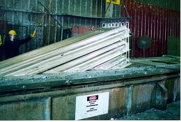

The short answer is no and the explanation is pretty straight forward. Imagine what happens when there is a little moisture on a steel part when it enters the hot-dip galvanizing (HDG) kettle. You hear some loud pops and see little splashes of zinc popping up from the kettle. If this occurs with just a little moisture on the steel surface, imagine if there was a lot of water sprinkling down on the kettle. The result would be disastrous.
The main purpose to have fire sprinklers is to extinguish or control fires. The use of fire sprinklers in a galvanizing facility would create dangerous situations instead of reducing and eliminating fires. Any type of fire suppression/sprinklers are typically excluded from molten material use areas because of this potential to develop a violent steam explosion.

Any water usage should be used with caution around the HDG kettle. The introduction of water or the insertion of wet parts into the HDG kettle can be explosive in nature. The water will instantly vaporize and can cause the molten zinc to erupt in all directions. The larger the volume of water, the more violent the reaction becomes. Due to the possible reaction between water and molten zinc, only dry chemical or carbon dioxide extinguishers should be used in the vicinity of the HDG kettle.
