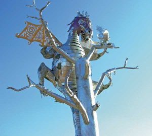

Nashville Children's Theatre Dragon, Nashville, TN
Hot-dip galvanized (HDG) steel is versatile and readily available. A wide variety of shapes and sizes ranging from small nuts, bolts, and fasteners to larger structural pieces, to even the most intricately detailed artistic pieces, can be galvanized. Because of the total immersion process, even complex fabrications can be coated entirely for corrosion protection.
