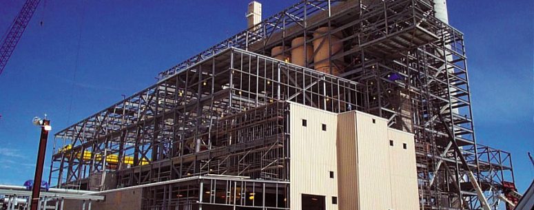

Life-Cycle Savings Case Study
Caribbean Power Plant, 2001
The Caribbean Power Plant was constructed in 2001 utilizing hot-dip galvanized steel. Originally the 10,000 ton project was specified to use a high-performance 2-coat paint system, but after the owner was shown a life-cycle cost analysis, he decided to change the specification to hot-dip galvanizing. Using the parameters from this project and the 2016 cost data, this case study will show the owner would still make the same decision if the power plant was built today.
The cost data used in the online calculator and this case study come from two sources. The paint data comes from a nationwide survey of paint manufacturers conducted by KTA Tator, a consulting firm specializing in protective coatings, in 2016. The galvanizing data was obtained from a 2016 survey of North American hot-dip galvanizers. Here are the parameters for the Caribbean Power Plant project:
  • Project Size: Over 10,000 tons (9,072 metric tonnes)
  • Structure Type: Complex 50-100’ high
  • Service Life Environment: Industrial
  • Member Type: Typical Mix Sizes/Shapes
  • Paint System: IOZ/Epoxy SP-10 Automated Surface Preparation 7 mil minimum DFT
  • Inflation: 2%
  • Interest: 3%
