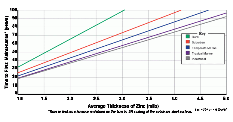

For the portions of the solar panel design which experience atmospheric corrosion only, it is possible to determine the anticipated coating life by referring to the Time to First Maintenance chart (Figure 1) regardless of whether continuous galvanizing or batch hot-dip galvanizing is specified. Simply refer to the minimum average coating thickness that will be achieved, based on the type of galvanizing. You will notice that due to the thinner coatings achieved through continuous galvanizing, it may be required to extrapolate from the data in order to obtain a time to first maintenance for the common coating grades G30, G60, and G90.  Alternatively, the Zinc Coating Life Predictor (ZCLP) can estimate time to first maintenance for both hot-dip (zinc) coatings by imputing site-specific parameters for the environment such as yearly average weather and pollution data.

Figure 1: Time to First Maintenance for HDG Coatings

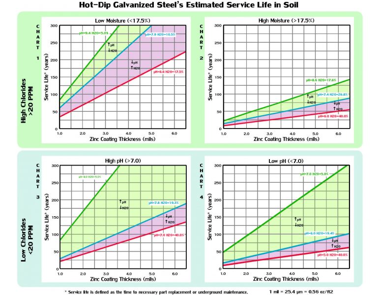

For solar mounting projects where galvanized posts will be embedded in soil, there are 3 corrosion assessment categories to consider:  atmospheric corrosion above-ground, corrosion at the transition zone, and corrosion in the soil. Typically, the portion of a solar panel post which is embedded in the soil will experience the most corrosive environment. To estimate the service life of galvanized steel articles in soil applications, refer to the AGA Soil Charts (Fig. 2) below to provide an estimate of how long the hot-dip galvanized steel will last maintenance-free based on three primary soil characteristics: chloride level, moisture content, and pH. In extremely aggressive soils, a duplex system, such as coal-tar epoxy applied over HDG, can be considered to provide increased longevity of the embedded solar posts (1.5 to 2.3 times the combined service life).
Soil  Chart 2016  English
Figure 2: Time to First Maintenance of Hot-dip Galvanized Coatings in Soil
