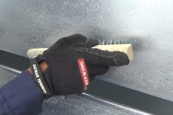

Hand  Brush
Hand Brush
No matter what type of adhesive product is used, preparation of the hot-dip galvanized surface is necessary to ensure a long-lasting bond. There are many similarities when preparing the hot-dip galvanized surface for placement of adhesives or for painting. If needed, the specification ASTM D6386, Preparation of Zinc (Hot-Dip Galvanized) Coated Iron and Steel Product and Hardware Surfaces for Painting, can be referenced as a guideline for detailed steps related to preparation of the HDG surface for adhesives.
Typically, non-structural adhesives (rubber based types of cement, tapes, stickers, etc.) require a clean surface free from dust, oil, grease, and loosely bonded corrosion products. Degreasing and cleaning can be performed in accordance with SSPC-SP 1 Solvent Cleaning.
Higher strength adhesives may require light abrasive cleaning (wire brushing or sanding) prior to degreasing to remove any zinc corrosion products and/or provide a textured surface. Be careful not to over-roughen the surface or remove too much zinc as to negatively affect the long-term corrosion resistance. Additionally, the use of an adhesive primer or etch primer (compatible with the adhesive product) may be recommended by the manufacturer for superior adhesion.
